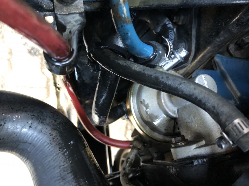

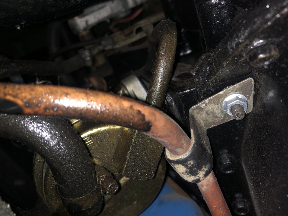

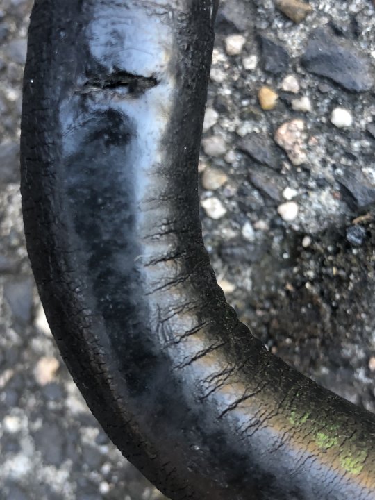

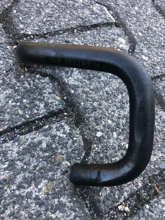

……..well, the last time I was driving, BIAB1 didn't really take the gas anymore. No more full power, suddenly accelerated on its own or eased off the gas……
I had changed the entire filter unit some time ago, there was a new filter cartridge on it.
Long story short……. after I exchanged the filter unit for a spin on filter……..just kidding ……….I changed the filter cartridge and everything was fine
I suspect because the filter cartridge was mounted on the filter unit and was stored openly for many years......something happened there, dirt, humidity etc......
………what can I say, now it drove normally again during a test drive………I come back, open the hood and see that…….
After a quick inspection I found this…….
………exchanged the good old preformed hose for a new piece of hose that unfortunately is only available by the meter…

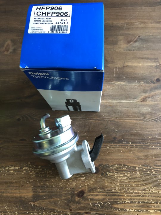

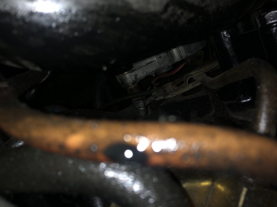

again a test drive, came back, open the hood and find this……. What I thought then, I'd rather not reproduce at this point, LOL
…………OK, of course I immediately ordered an electric pre-supply pump……. You can't trust the mechanical stuff...... …….Sorry, that had to be done, I just can't stop joking……
Of course I still have a suitable pump in the basement... but it's only for absolute emergencies (Airtex cheap) so I ordered another Delphi because I don't need the car at the moment... why the pump came to an end so early, it hasn't had that many miles on it yet?……….why all this has to happen to one man in one day?………who knows.

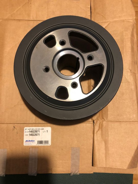

……….another thing I almost forgot……..many oil deposits have formed in the area below the front crankshaft oil seal…….. something had to happen
………so the front crankshaft oil seal and the crankshaft damper were changed.
After removing the old crankshaft damper, it became clear why it was so oily……….many small rust spots were on the shaft, so the crankshaft seal could no longer seal properly.
I was surprised that the rubber parts of the damper looked like new.....no cracks or anything like that.
A new AcDelco damper was installed……….. and now everything is dry again and as it should be

Good work. It’s nice to see how much you care about this M1009. She deserves it. Lots of issues can be prevented if the truck does not stand outside in the weather all year long. This is what I would work on. Finding a dry and safe spot for her. How many miles did you put on since the truck is yours?

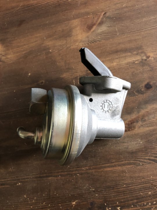

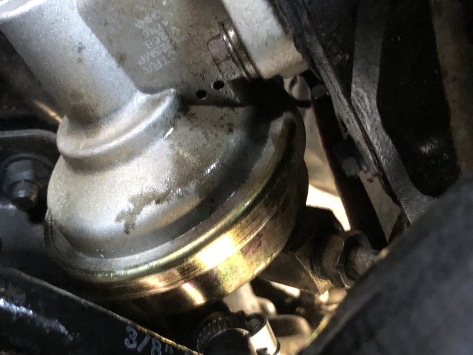

……..Lift pump has been changed.
After I removed it, I saw that actually only oil comes out of the opening.
……..at some point I had heard that if the CDR valve no longer works properly, oil is then blown out of the sump hole by overpressure………. then oil is blown out of the small holes in the lift pump
……..so I changed it right away.
……..now after an extensive test drive I can say everything is tight again and as it should be………we won't know what it was exactly (Lift Pump, CDR Valve) I'm just glad that everything is fine now

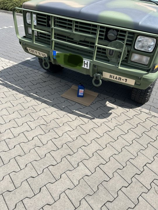

……. 3 weeks ago ………I was at a vintage car exhibition…….cardboard sheets were handed out at the entrance…….. when I asked what they are for………
they said to me that this is a condition of the parking lot owner ...... they have to go under the car because of the oil stains.
…..I didn't want to disappoint anyone

Nice to see that you were NOT dribbling on the pavement!
Hate to say it, but that little piece of cardboard isn't big enough for some vehicles...
