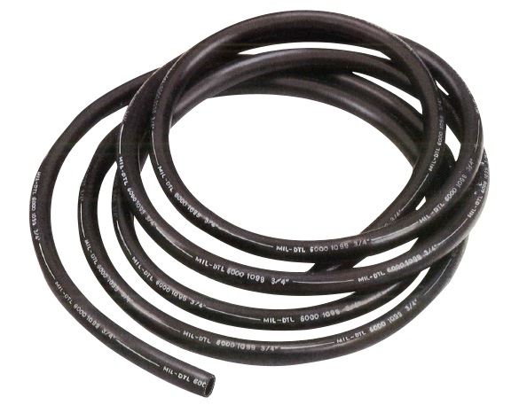

Trying to keep things as bulletproof as possible.
The power steering return and cooler lines were
compromised. Tiny little gouge hole I found in one
so off to replace. Found a company named
AirCraft Spruce & picked up some quality hose.
THEY HAVE EVERYTHING HOSE!
Spendy but TOUGH... That return line connection
at the pump is BURIED up in there, I want to put
it together once and have it LAST!

This is what you need, If it were me, I would turn the governor around to match the way it sits on the old engine. Call if you need help, it takes 5 mins.
If you go to BPS truck parts in Irwindale, they probably have it. OR, leave it open when you turn the governor around, the port will be facing down and no issue of water into the port.
Again, call me if you have issues.
Crap! I listed 22 line items, tried to remember it all! Roger THIS!
I will plumb it up...
