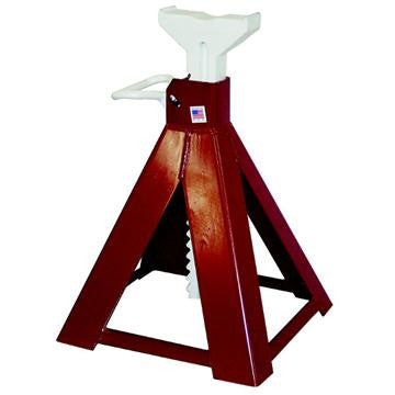

Any concerns with running my engine while the front wheels are off and I am in jack stands?
I have done it with cars, but these trucks are more vibrating and heavy.
Wheels are chocked.

All depends on the quality of your jack stands. I haven't found it to vibrate excessively that I can't have it on a jack stand while running.
I have the 22 ton Harbor Freight ones. The saddle does not wrap the axle at all.

I wouldn't trust anything from HF to hold up a 20k lb truck.
The military uses these for FMTV's:
Normally I agree, but the design of these is pretty hard to screw up and there is a huge over rating.
Watch out on asphalt with this style, the sharp legs can sink in.

19" vs. 31" height - and USA made for $60 more. No comparison IMO.
I don’t need the height….You are comparing 7 tons capacity with a ratcheting lift made from thin bent steel to a 1” pin with all thick gusseted and welded steel. They are apples and oranges.
Granted the ones you pointed out have a place and are nice…. The HF ones I am using are stronger, simpler, and do the job. I actually would trust the HF design more.
Chinese vs American Made.
Seems to me that $60 more might keep an American working...
Sure, but we are talking about two different products. The American 22 ton jack stands are $400 more. I am not a business that needs these stands every day. If the difference was $60, then I would have bought them. At $550, I would have made my own, but at $150 from HF, it was not worth my time.
