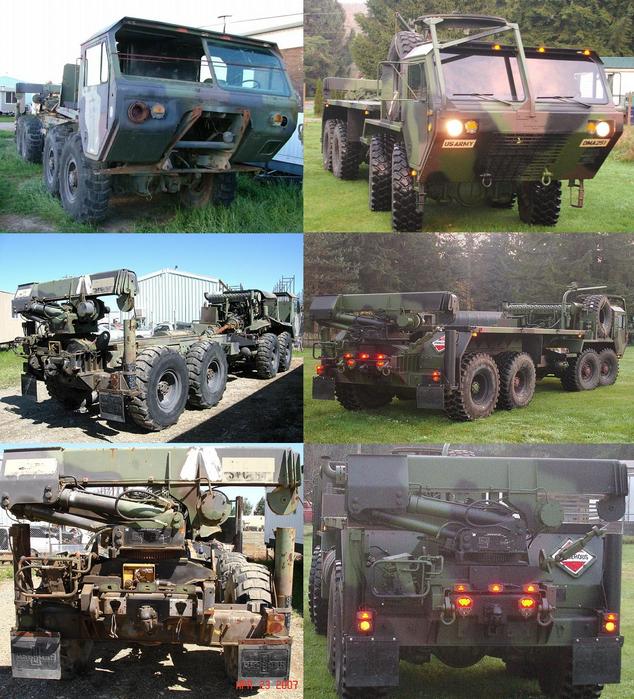

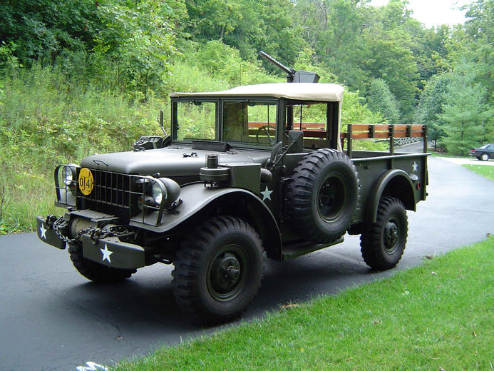

Hey, Thanks guys! Here's a photo-collage I made a while back of it. I hope it is big enough.
I'm on to new projects, but I still have a big 40,000 lb. spot in my heart for the big guy.

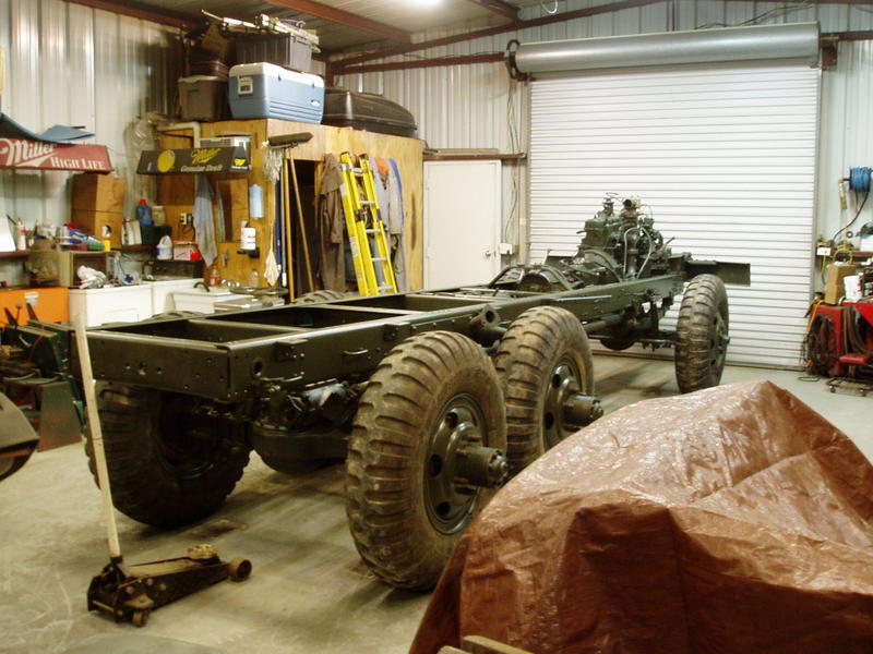

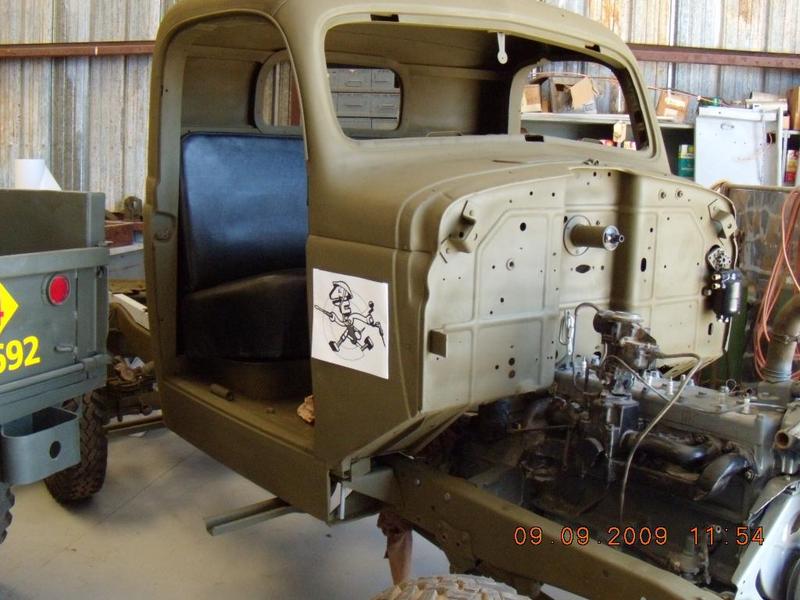

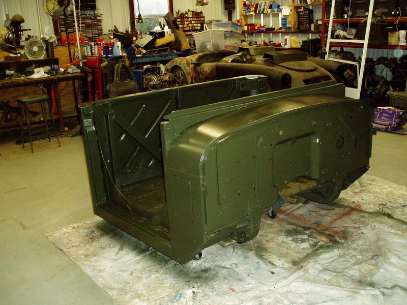

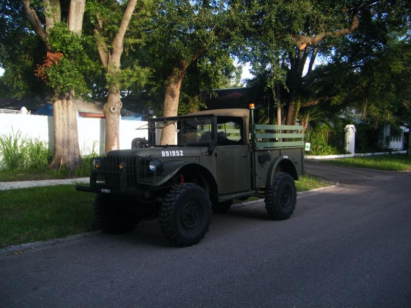

Thanks, the truck on the left is the one I built. I will include the picture here again so you don't have to go back to page 1.
Anyway, I took the labor intensive yet cheaper way of doing it. 4-1/2" composite sanding pads from HF mounted to a small grinder. Went don't to bare metal and bare frame. I still have to do the bed since a M35A2, M105, M105 and M101 came along about the time I was going to finish the truck off. Now that it is getting almost comfortable outside again, I plan to pull the bed, strip it and paint. Gillespie 24052 USMC forrest green is the paint. I got it from Mark at Rapco.

Barrman that is just incredible on what you did to that truck. did you use the other one as a parts truck? and for sanding you just use like a drill? and some sand pads? i have to sand some spots on my trailer and i used a bit on the drill and thats not working

I found the part number for the sanding pads:
94017 from HF.
Also, read this thread about what others have done to sand down.
http://www.steelsoldiers.com/paint-bodywork/19487-5-hours-35-a.html
Thanks again for the compliments. If you go all the way to the frame, do all new fuel lines, brake lines and brake hoses. The air pack and master cylinder are so easy to get at with the cab gone as well. Don't be like me and wait until the cab is back on to do the master/air pack. I did the lines the easy way though.

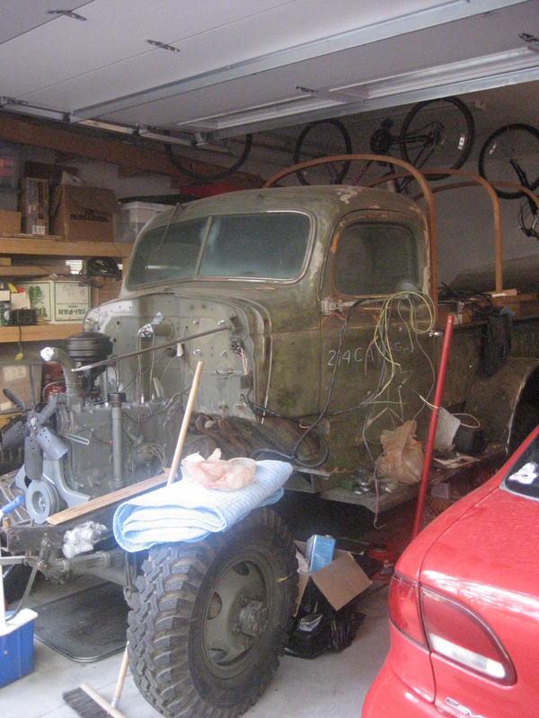

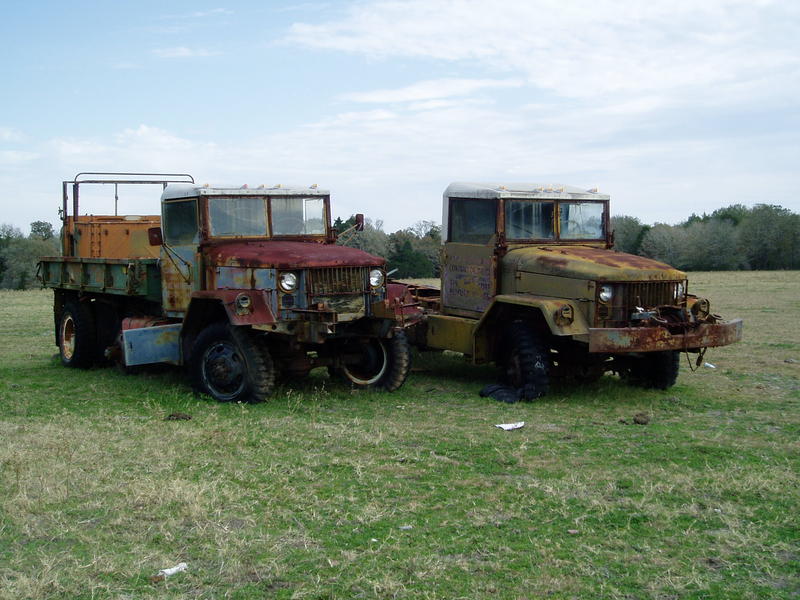

Oh, the other gasser is pretty much as it was in the picture of when I first found them. 6 tires that hold air, missing its winch and bumper, radiator, pto shaft, air pack and 1 little bitty part on the carb I broke off on the good truck pulling the body are all that has been changed.

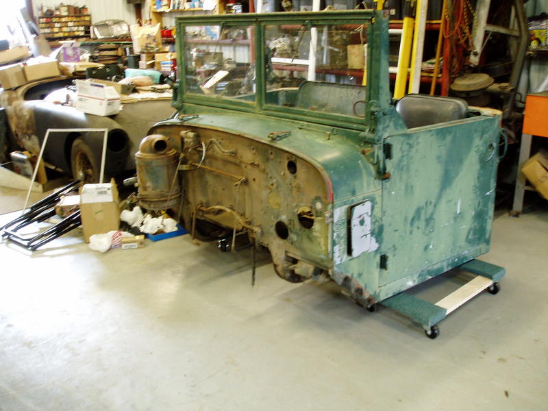

Kwai actually found a good rust free cab in Kalifornia. Shipping was arranged and that made the project go a lot faster. Here is a shot of what I got to start with. Lots better than the other, but a 1953 cab instead of my stock 1952. The little differences drove me nuts trying to go all 1952.
