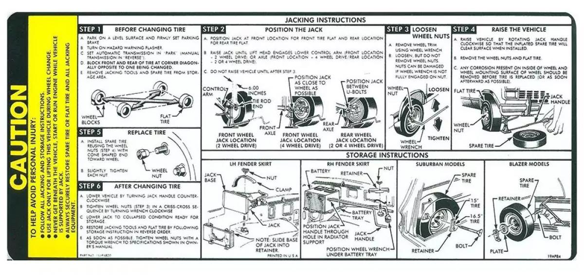

Just a few sneak peeks of my progress. It has been a long-drawn-out job and I am not completed yet. Someone brush painted CARC in the cargo area and was very sloppy about it. They sprinkled non-skid grit in it and that made a real mess. I have been digging, sanding, wire brushing my way thru that poor job they done. I started a few years ago and I am still at it. Really. I will paint no floor until I think it is ready for paint. LineX would have been easier. But who wants easy? With a floor this nice I want to paint it and flaunt it. View attachment 900148 View attachment 900149 View attachment 900150 View attachment 900151 View attachment 900152 I am not very proud of the jacking instructions decal. I am still searching for one. View attachment 900153 I am proud of the condition of the floor and cargo area. View attachment 900154
Thank you for looking and Be Safe. I am determined to get this project as perfect as possible.
A little squirt of WD-40 and some elbow grease will clean up that jacking decal like new.
Just what I need. Oils and silicone all over a sanded surface that I am ready to paint. I can just ignore it and cover it or scrape it off and paint it. I never needed a picture to show me how the jack, tools and tire needed to be stored. But I do want it as original as possible. I am looking at other options. i wish i could find a clean decal to get a picture. Thank you, Doug but I think the WD40 is not a valid option.
Rick
Re-glue those corners first. Add wide painter's tape around the decal. Spray WD-40 "directly on a scrubby pad or rag" then add in some elbow grease and your problem will be solved.
Just saying .
Or is it because you don't own any WD-40
