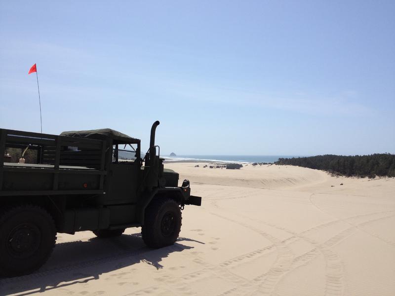

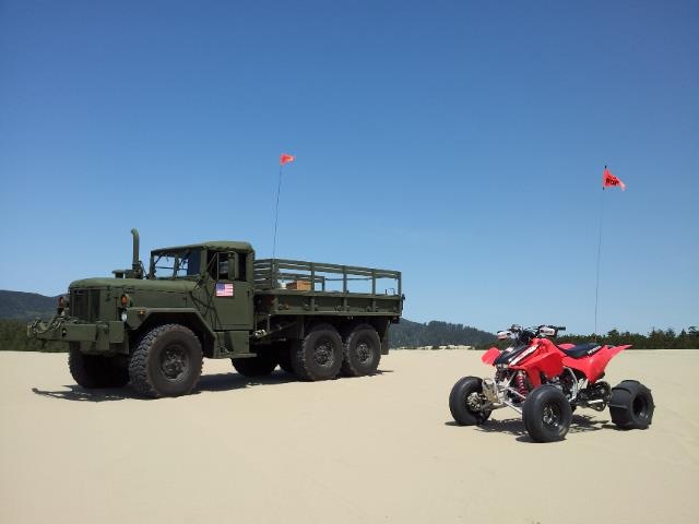

I couldn't find many posts on anyone taking dueces in the sand dunes, so I figured I'd share my experience.
Took the A3 out to Sand Lake for the day, and what a blast !
Started out with the tires at normal road pressure, and could get around ok but it did not like any sort of hill.
Dropped all the tires down to 20psi and had no problems anywhere I went.
I didn't try any crazy hill climbs or anything (probably wouldn't work out to well) but was very impressed at how well it handled the sand dunes.
I'm planning another trip soon, and think I'll try the pressure down at maybe 10-15psi and really put it to the test.

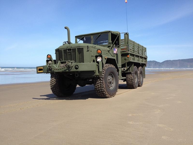

Great looking truck. Love the rubber on your truck, too! Did the truck come out with those tires? I've never seen an A3 with those tires before, but they look awesome!
YOUNG GUN
155
10
Sherwood, Oregon
Thanks guys !
It came with the standard 14.5 x 20 Michelin X Radials.
I won 8 brand new Goodyear MV/T 395/85R20 from GL and put those on, and I couldn't be happier with them.

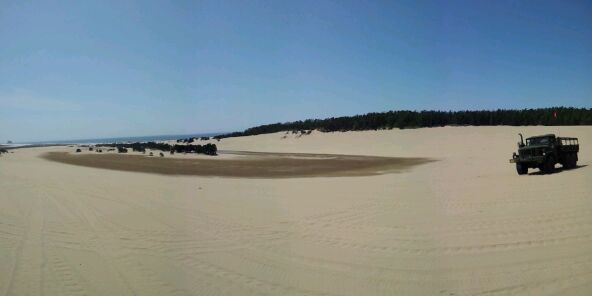

Great pictures, thanks for posting.
I LOVE pic #4-great shot.
