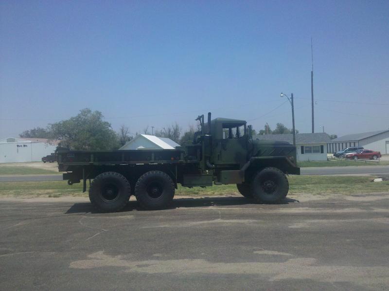

This will be the first post I've put on here. I have crawled around on here trying to find information for some 68 deuces, but that's it. I am the Assistant Director of Fire & Emergency Management for Stafford County, KS. I just accepted delivery of our new 5ton today. It has 17 miles and just under 40 hours since military rebuild. I post some pics later today, and keep update on the transformation this truck will take. Let me know what you think, and any ideas or tips is appreciated.

This truck will be used as a large brush truck. It will hold 1000 gallon water tank and equipment. Most of the stuff will be swapped from a deuce to this one.

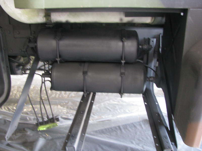

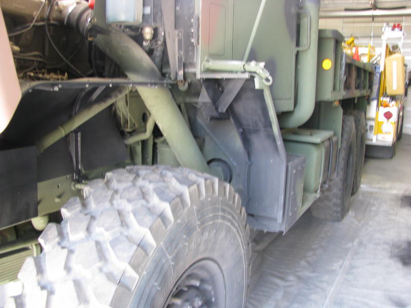

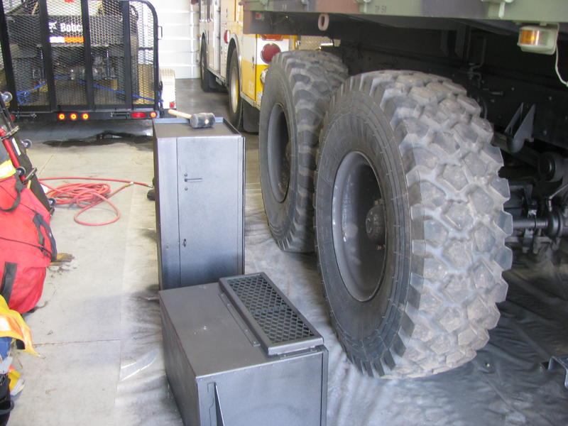

Undercarriage has been painted black, and bedliner applied to some areas. Drop sides removed and the spare tire and crane removed. LED emergency lights and spot lights have been ordered and are here. A 12V specific fuse block is ordered and almost here. Quotes are coming in on a new 1000 gallon low profile rectangular tank and paint job for the cab. Initial layout and planning is underway on the bed and for a remote controlled monitor mounted to the front.

Quick update. I found a trailer. The truck is almost done being painted. The bed is on it's way to being cut apart. The exhaust should be done in a couple days. The truck that we are swapping parts from is almost all torn apart.
I am still having trouble with pictures, and we have had alot of fires so not much time to try and figure it out. I believe it is because they are too big. I use Picasa at home, so I'm gonna download it at work and try that way.
The exhaust is just moving around the corner a little way. I will look just like the air intake on the driver's side.
the bed is the hardest part. Not because of the work, but because it is in perfect shape. A couple holes will be cut in it and the front pieces will be removed to extend it forward.
