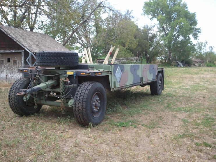

I'm pretty sure he wants the trailer to act as it's own tanker and pump with a 2,000 gallon capacity. Giving the truck/trailer combination a 3,000 gallon capacity in total. Thats going to be a lot of weight to move, and more importantly stop.
nlauffer,
I'm just curious how much the extra equipment weighs.
~16,700 lbs in water alone (not counting tanks, pumps, genset, fuel, misc equpiment) in the trailer.
~8,350 lbs of water alone (again not counting tank etc...) in the bed of the truck.
Looks like a great combination of truck and trailer. Excellent idea to have the trailer able to operate independantly (although not mobile). Make sure the ABS is working, they had some issues with that when the M923 is shut down improperly.

The trailer I believe is rated at 22000 lbs. Yes this is a heavy load, but these trucks are very capable. The truck has a full military rebuild with about 40 hours on it. ABS, brakes, engine, trans, tires. All in great shape.
The truck will be finished first and then weighed.
Going off the TM, the truck should handle the weight of this combo. As well speaking with some guys that used these trucks overseas. They will handle much more abuse than the TM says it will.
748
Woodstock, GA
I'm sure the truck will pull it. I was just a little concerned about the load rating of the trailer axles and tires. Good luck with the build. Keep us posted with updates and pics.

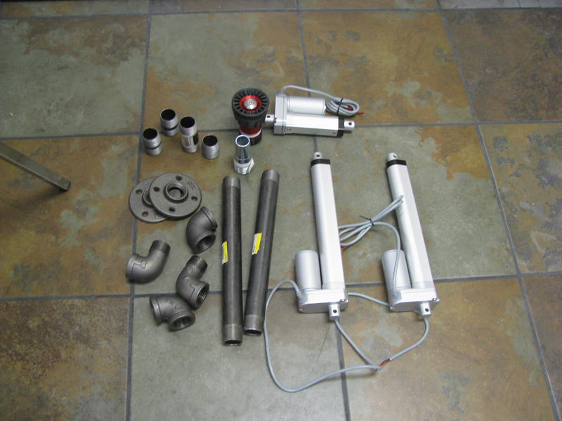

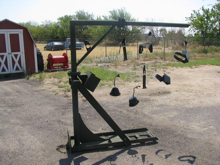

If that is the case, I'll let you know that we have a side project going. We are making a remote wildland fire monitor that will attach to the bumper. These sell from $5000 and up. I have all the parts, but two pieces sitting by my desk. The total will be around $500.
nlauffer
42
Saint John, KS
Here are the parts we purchased. There are two swivels that are not pictured, they are on backorder. It also turns out the actuator at the top (small one) is too big. It has a 2" stroke and we only needed .25" stroke. That will adjust the spray pattern.

Actuators are from www.dcactuators.com and the part number is 6108T. Two of these are needed at $114.00 each. Plumbing parts from the hardware store are somewhere around $20.00. I bought a nozzle from Cascade Fire equipment for $30.00. A mounting plate will need to be fabricated to mount to the bumper or wherever. Piping water to it and deciding on a shutoff valve. We will be using an air operated valve for ours, but just a simple t-handle valve could be used.
The Roscommon monitor is a nice setup, but we did not want to put that much time into it, this go around. The shielding and left-to-right movement are the main differences. We are also looking for a joystick for controlling it instead of switches. I have most of the parts and part numbers and prices, but we are not finished yet. When I finish this project I will post a complete part and price list and build guide.

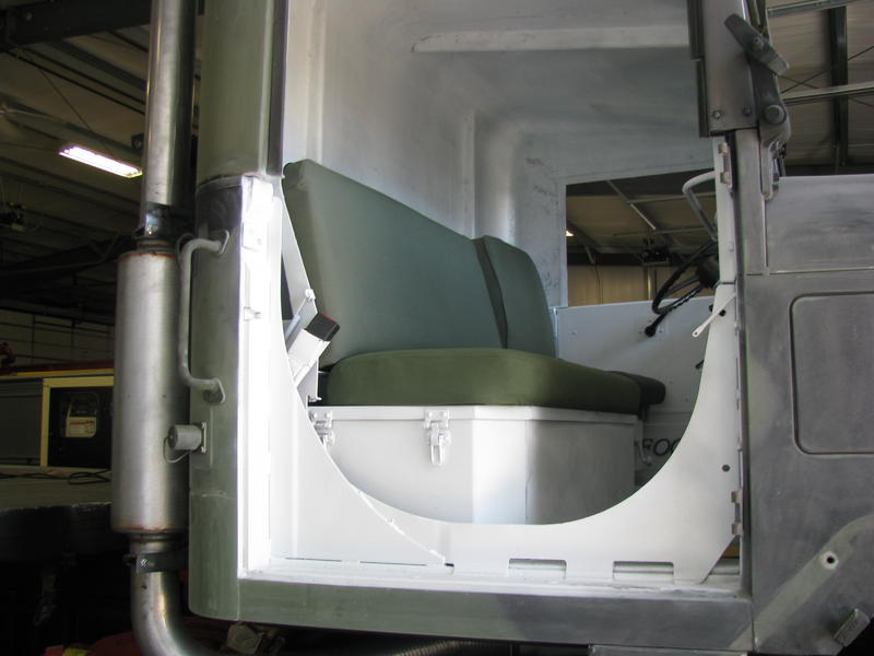

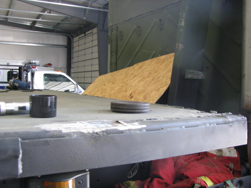

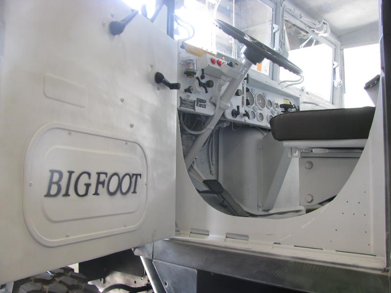

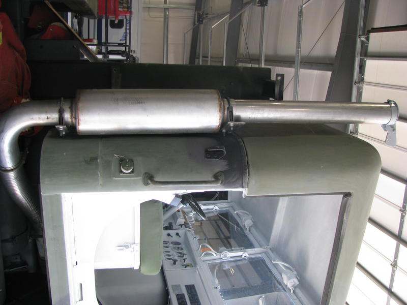

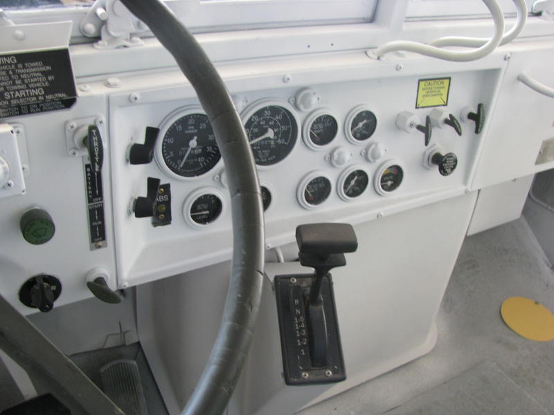

Thes pics are just some during pics. The first one is where we had cut the front of the bed off. The second one (the sideways one) is the exhaust setup before high heat paint. The 3rd, 4th, and 5th are of the interior as it was getting painted white. As you can see the outside had not been painted yet.

Also, if you look in picture 4, you will see where I had removed all the MWO tags and rebuild tags. I noticed there was someone on here looking for MWO tags. If that person is still looking and doesn't mind already dated ones. I will look to see if I still have them.
