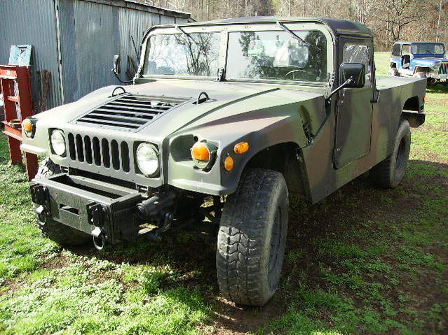

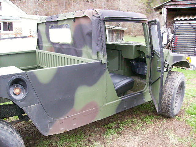

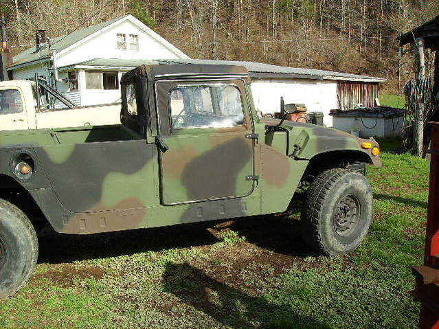

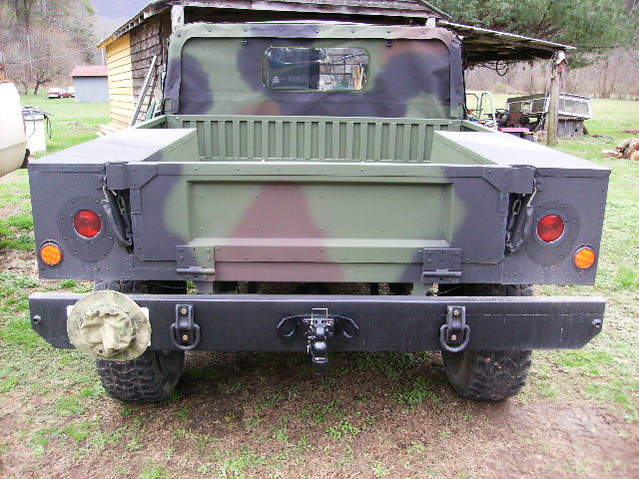

I like your comment emr. I started this project last year when I purchased a couple of top kits really cheap from a
SS member. Later I read on this site that Patracy was thinking about a similar project,he even started a hmmwv blueprints thread. I'm not sure what happened to his project . Anyway ,I was able to measure a real Humvee at the local sheriff dept. and with a lot of comparing dimensions with the doors and top from my new top kit ,plus purchasing a actual hmmwv hood and windshield frame was able to form my plan to build a dimesionaly correct hmmwv style truck. gerrycan, your correct on the steering box being dodge sourced,but the frame and axles (dana 44 and dana 60 ) came from Ford pickups.

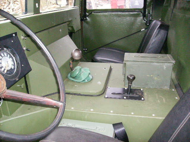

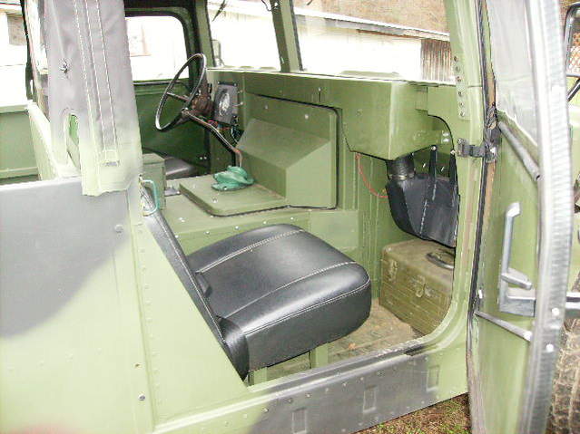

Thanks,for all the comments. The engine is a ford 300 straight 6 attached to a np435 4 speed and 205 transfer case. Had to move the engine and tranny back severel inches ,also lowered the combo in the frame.

Well I think you chose a darn near indestructible power pack for that rascal!!:papabear: says :goodjob:
