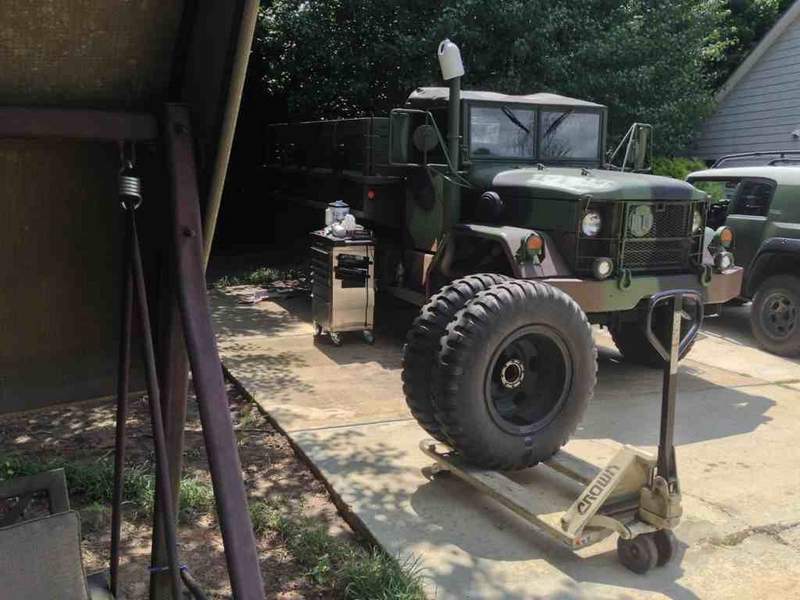

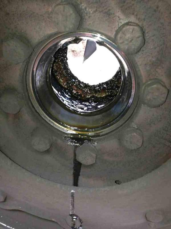

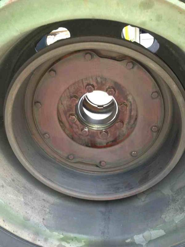

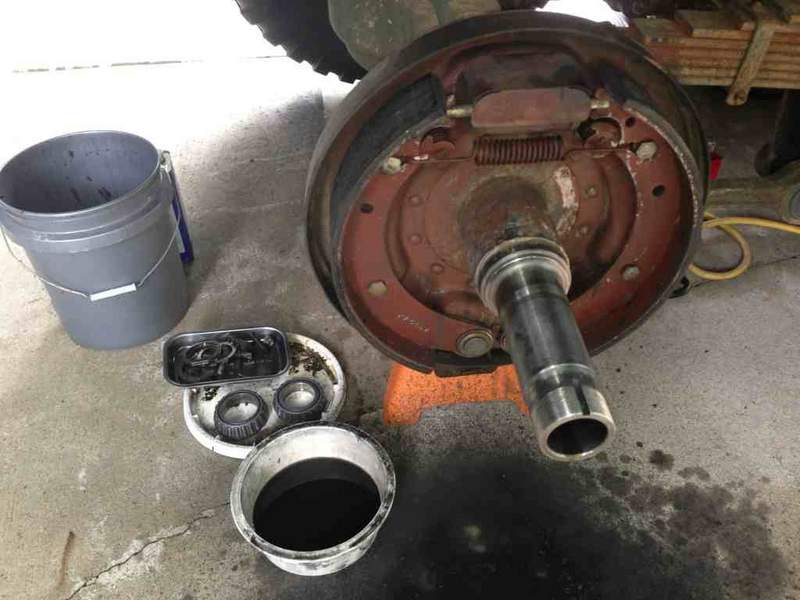

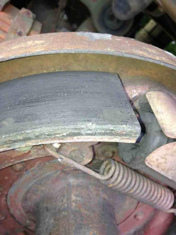

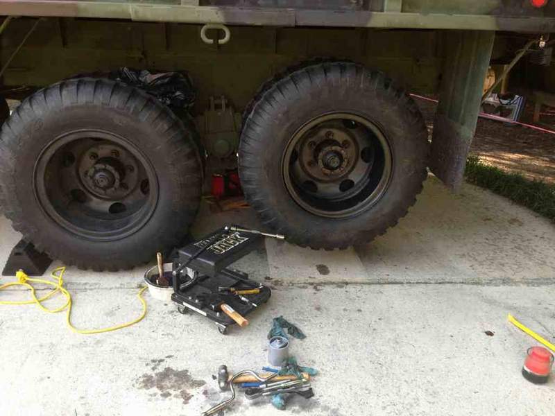

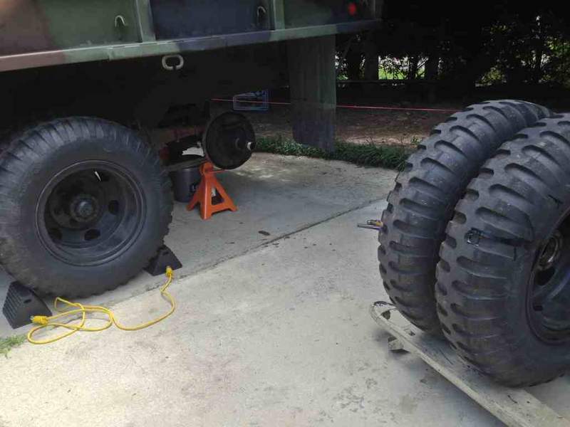

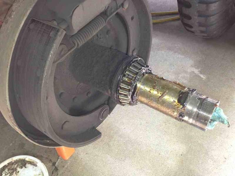

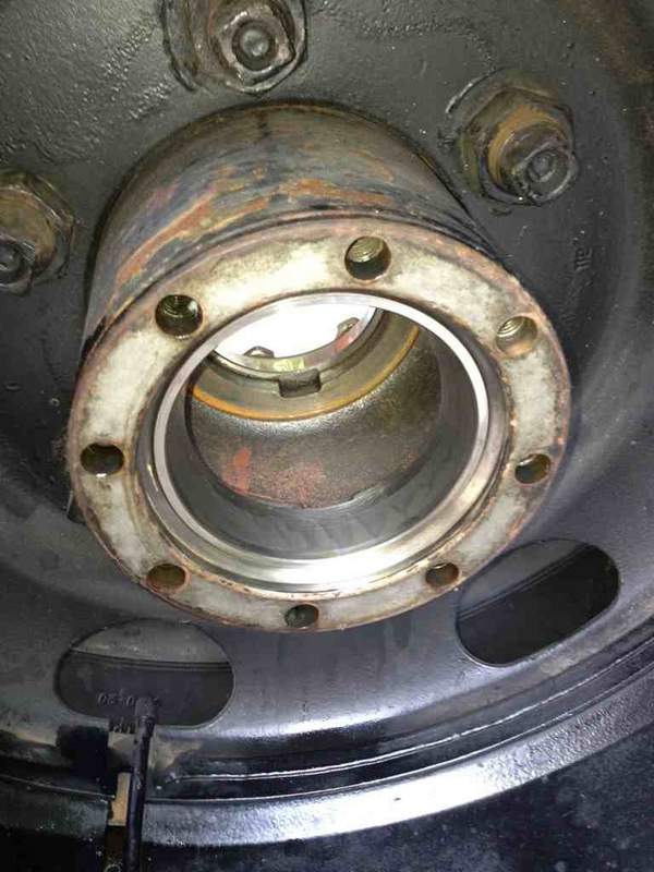

I decided I should do at least one hub on my own before I had Clinto do the rest. I wanted the experience of doing this and hey, maybe it's easy and I can just do them all. Not.

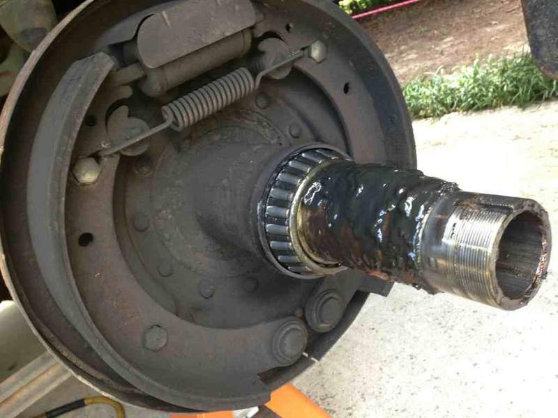

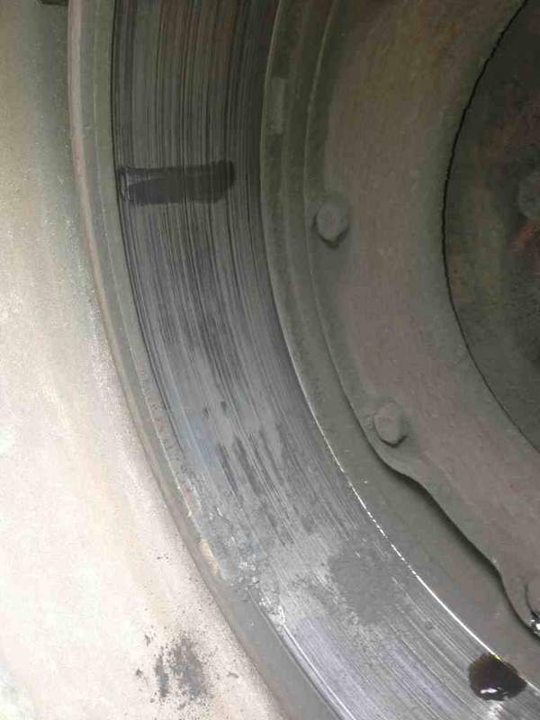

Well, the work isn't bad. I had the first hub (left rear) off in about 10-15 minutes. I found that the inner seal had leaked some 90w into the hub and washed most of the grease out of the bearings. I had no visible leaks, but the inside if the hub was a mess. The bearings look ok, but I'll have to clean them up and inspect them more carefully. The brake shoes are pretty thin and the inside of the drum has surface grooves. It looks like the credit card balance is going up again.
Rear axle supported on stands. Note the pallet jack on the left side. That worked really well for pulling the wheel/hub assembly.

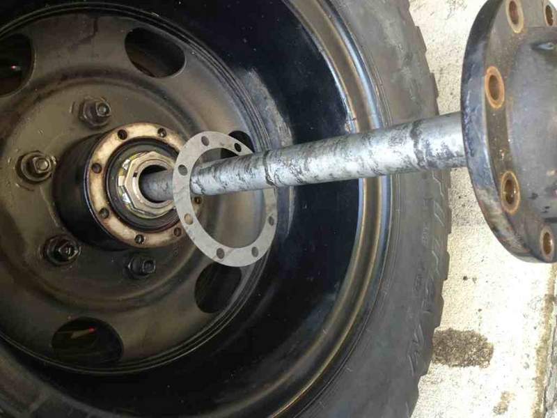

Inside of the hub. It's a wet, sloppy mess in there.

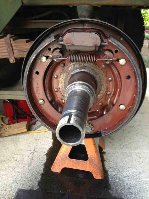

Spindle and brake assembly. Yeah, that's a mess too.
Inside of the brake drum.
Hub and wheel assembly sitting on the pallet jack.
Brake assembly and spindle after two cans of brake cleaner and work with a soft bristle paint brush.
Next, I've got to clean out the hub and drum and see how that looks. I need to take some measurements on the drum to see if it can be turned.
This is not going to be the quick and cheap job I hoped it would be.

I got the goo cleaned up and I'm starting the reassembly. The shoes are ok and I can live with the drum condition for now. If the rest are in this condition, I'll plan a full brake job for later this year.

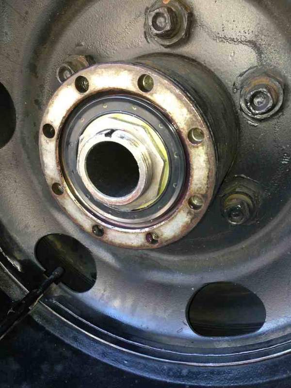

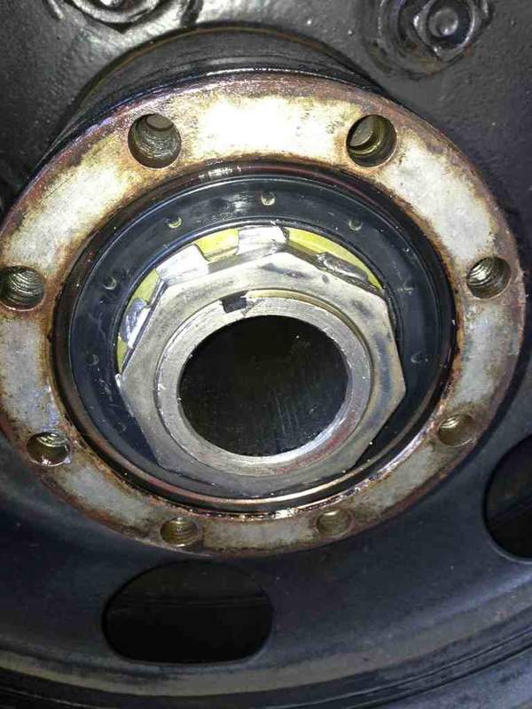

I quit working on the truck yesterday to go watch my boy ride a 4-wheeler and then join him and his "Poppa" for some dinner. Have to work this afternoon but I managed to get the right rear hub back on the truck with new seals and fresh grease this morning. I used "The Right Stuff" to plug the keyway. I have 2 worries at this point:
1. I'm not sure I have the outer seal in correctly. I installed it with the "cup" side toward the bearings. I read and re-read the TM but I didn't find any place that indicated the correct orientation. It says "as shown" but of course the diagram doesn't indicate which side goes in.
2. I'm not sure I have the preload set correctly. The TM says to tighten the adjusting nut until it binds the wheel and then back off an eighth of a turn. Well, I torqued it on there pretty good and couldn't get it to bind the wheel. I backed it off and did it again several times and finally decided that the point where the wheel no longer had any lateral movement and the sound of the wheel rolling changed (silent) is "the point." I then backed it off just enough for the locking tab to engage. The wheel rolls very smoothly, makes no noise, and has no lateral movement to be felt or heard. All I can do now is drive it and check the hub temperature to see how she does.
So, do I have that seal in there backward?

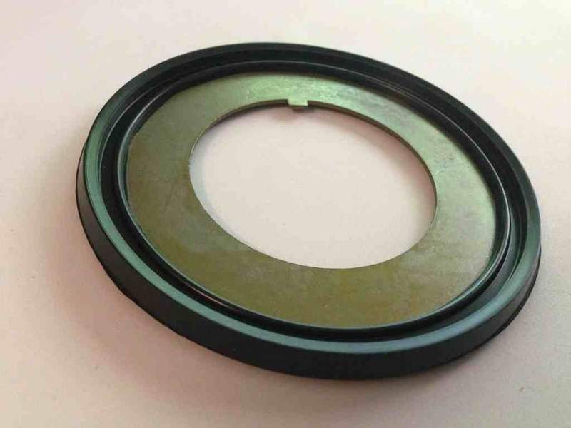

ImageUploadedByTapatalk1375194072.451719.jpgImageUploadedByTapatalk1375194081.601505.jpg
TMNT
789
Canton, Ga

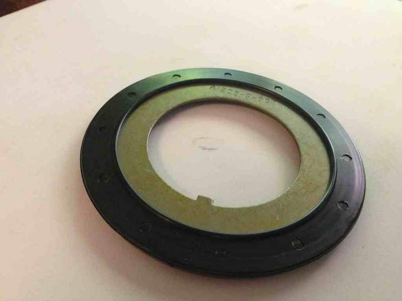

Here's a couple of photos of the outer seal.
Does this side (Side A) go toward the bearings, facing inward? (This is what I chose.)
Or, does this side (Side B) go toward the bearings, facing inward?
I guess I could just go ahead and open the other hub on the rear axle and look at how it is put together, but just because someone else did it, doesn't mean it's right.

12,609
1,164
You have it correct. Side A faces the bearings, side B faces the outside.
Bearing preload: I know the TM's call for the method they do, but once you've done enough bearings there's a "feel" to it. Not too loose, not too tight. Most people err on the side of too tight, which is worse. I'd rather them be a little looser.
It's hard to describe but I could show you in 30 seconds. I crank them down tight to seat the bearings, then back off, then tighten back up to where there's no rolling resistance and no movement.

Thanks, Clint. I had a 50/50 shot and I guessed it right!
What you described for setting the bearing preload sounds about right for what I did. I cranked it in there pretty hard and then backed it out again. I tightened it up until I couldn't feel any lateral movement by rocking the tire back and forth by grabbing the top and pushing and pulling. At that point the wheel rolled very nicely with no noise. I backed it out until I could just pick up a little clicking feel from pushing the tire around with a pry bar. Where I set it, is in between the clicking noise and no detectable movement. I'll run it there and see how the temperatures are. If it runs warm I'll back it out a little.

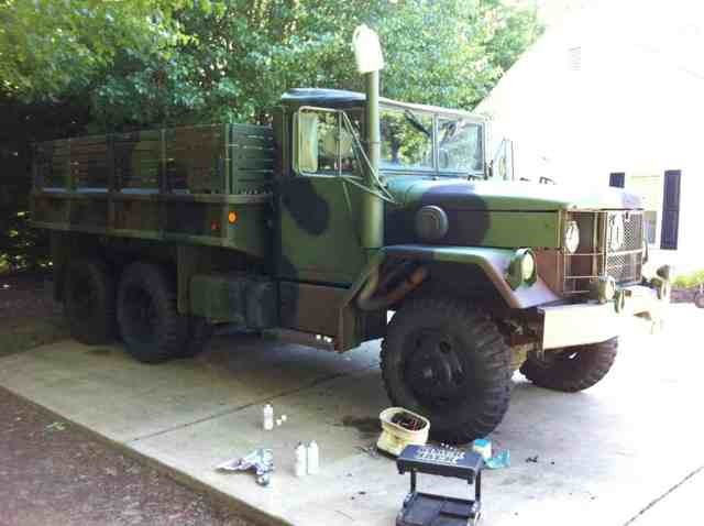

Finally getting back at it on the hub servicing. Working on the right rear now. This hub had 90w intruded into the hub as well. This one also has some water droplets. Again, there has been no external evidence of a problem. No gear lube leaking out, no heat problems, and no bad noises.
I am now convinced that the hubs should be opened, inspected and serviced at least every 6 months, even when there is no evidence of a problem. At least there are no signs of bearing, race, or spindle damage. And, in fairness, I have no idea how long it's been since these hubs were serviced. I've had the truck for a year and a half, so it's been at least 2-3 years and maybe 10,000 miles. I know, my bad. I should have done this a year and a half ago. I thought it would be more difficult than it is so I kept putting off. Other than the greasy mess, it's not a bad job to do.

Got the hub and bearings cleaned up and guess what? Yep, here comes the rain again!
This hub was not nearly as messy as the left rear. The intrusion of 90w was not bad, so the grease was mostly just grease and not the grease/90wt/water/peanut butter that I had on the left side.
TMNT
789
Canton, Ga
Finally got to finish the right rear hub. It's back on with fresh seals and fresh grease. I cleaned and checked the axle vent and adjusted the brakes on that rear axle. The diff is filled with fresh 90Wt.
Next I'm checking and servicing the trunnions and then moving on to the middle axle.
