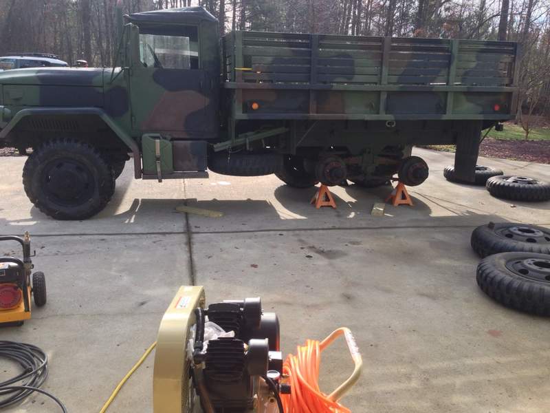

After getting some sleep and thinking on the leaking hub issue a bit, I think I have a plan. Early Saturday morning I will open up that right-middle hub again and check it out. I think I may have the adjuster nut just a bit too loose and that's causing the leak. The rear axle is doing just fine after I went through it the second time.
I think I can get it done in an hour or two and not impact the moving operation. I should be a dang expert on hubs after this! I can almost break them down and put them together in my sleep now. If I could just learn how to do it right.

Yesterday morning, I went back over to the old house where Betty was still parked and worked on that leaking hub on the middle axle. The preload was correct and it wasn't overly loose like I thought. The seals look good and the keyway plug was intact. The only thing I can come up with is that I had the differential way overfilled. I made the same mistake on the rear axle.
Just another case of too much of a good thing is usually bad. The slight sideways slope of my driveway, combined with me filling the diff until the lube backed out of the fill/check hole, caused me to have about 1/2 gallon too much lube in there. I had to jack the low-side wheel up a good 3-4 inches to get the axle level, and then I filled it to about 1/2 inch below the check hole.
Incidentally, the hub that was leaking was on the "downhill" side of the truck when parked in the usual spot. I think the excess lube oil pooled up in that hub enough to cause the problem.
After getting that fixed, we loaded up more "stuff" for yet another load to the new house. It's about a 30 minute trip and everything worked like it's supposed to with no leaks and normal temps.

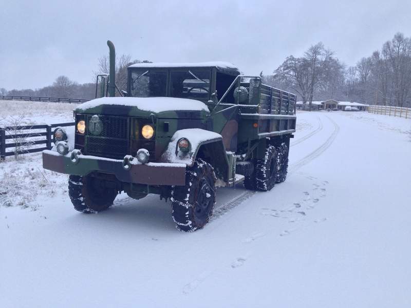

We survived Snowpocolypse 2014 with no damage and we never lost power. We are among the fortunate and we're grateful for it.

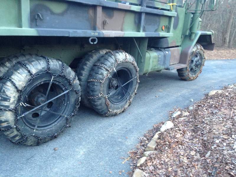

Last Sunday, I took the time to put the snow chains on Betty, just in case. It was weird out there sweating in 60 degree temps, putting snow chains on in preparation for a "catastrophic" winter storm.
After all that work, I couldn't pass up the opportunity to take Betty for a drive around the 'hood this morning. The snow is about an inch of sleet and then a couple of inches of snow on top. It is really not bad. Certainly not as bad as the ice that we had a couple of weeks ago.
Betty started up great this morning on the third bump of the starter button. The chains work wonders and Betty went wherever I pointed without so much as a tire slip.
Chains put on Sunday. My first time with chains. I put the rubber bungies on as extra insurance. Some I had to do twice because they were twisted. I should have jacked up the wheels to put them on. I'll do that next time for sure.
She looks good in the snow.
