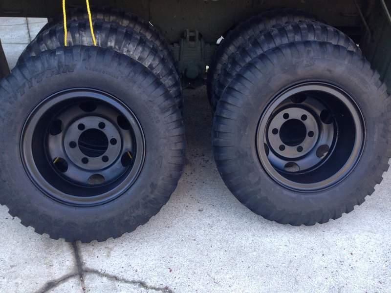

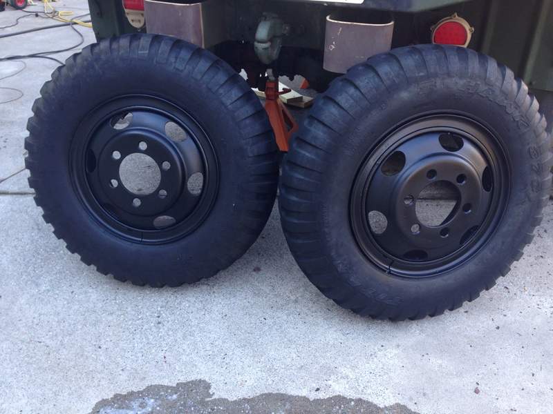

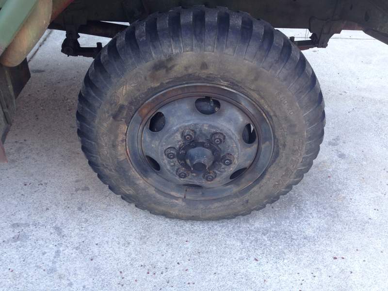

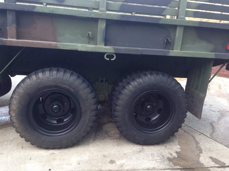

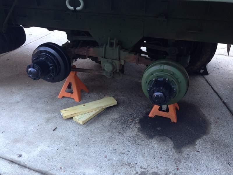

I mostly finished the left rear set of wheels and hubs. There were some distractions, but mostly I was just taking it easy and enjoying this great 65 degree sunny weather. ImageUploadedByTapatalk1394329434.726780.jpg
This is what they looked like before. I still have the right rear and both fronts to do. The winter mud, snow and salt really did a number on the wheels.
TMNT
789
Canton, Ga
Nice job, what kind paint?
I scrubbed the tires and wheels with degreaser, a good brush, and then pressure washed with a 25* tip. After they dried a bit, I hit the old paint with a rotary wire brush and used a die grinder with 80 grit on a couple of spots that needed extra attention.
After blowing off the dust with compressed air and wiping them down with alcohol, I brushed some Rustoleum Rust Reformer to the spots that had light rust and bare metal, especially the spots that I couldn't get into with the wire brush. The reformer goes on a bluish-white but dries to a flat black.
The reformer needs 3-4 hours to dry before applying oil based paint, so I let them stand in the sun for a good three hours while a did some other stuff.
I used Rustoleum oil-based semi-gloss black, applied with an HVLP sprayer dialed down to a small pattern light fog. I applied 4 coats with about 20 minutes between each coat. The light coats dried quickly with the warm, dry air and sunshine.
It was the first time I've sprayed oil-based paint so it took me a bit to get the sprayer dialed in. It was spitting paint globs at first but a little bit of Flotrol and dialing the air up and the flow down I found a good setting that gave me the fog I wanted. The gun still slobbered a bit so I had to be careful to wipe the tip clean every couple of minutes.
I like the results. I did the inside and outside of each wheel so they're good now for whatever position I use them in.

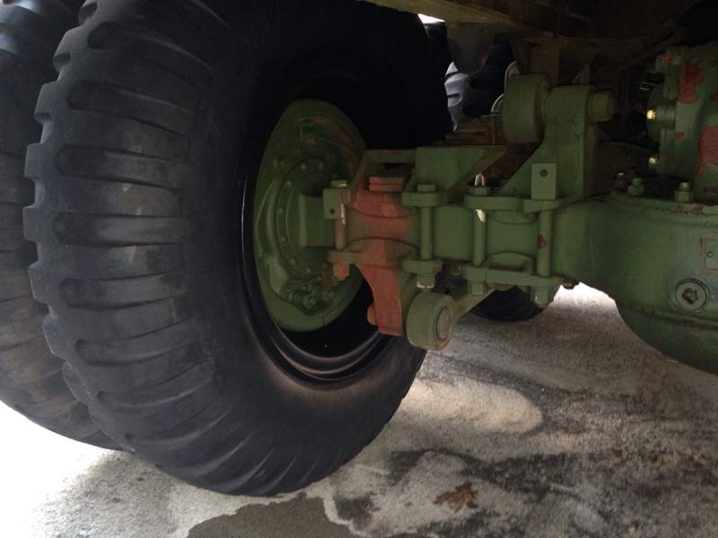

Anyway, I found a couple of hours this afternoon to get a little more done. The left rear set is all mounted up again and the left front is off, washed, and touched up since it was painted back in August, so it wasn't bad after I got the mud off of it. I need to replace the grease boot, so that's where I'm stopping for now.
The outside part of the wheels will get one more dose of paint after I get them all done and back on to cover the scratches on the hubs and the lug nuts. I think it's impossible to mount these up without scratching the crap out of the hub.

I found the detail interesting but was surprised you used Floetrol (for latex/acrylic) instead of Penetrol (for alkyd.)
Steve
So that was a mistake. I had Floetrol sitting on the shelf from my last paint project (Behr house paint) and like I said, I've never sprayed oil-based paint before. I didn't even think to re-read the label because my mind was telling me that it was for all types of paint. Your post prompted me to go back out there and look again. Lesson learned and thankfully, on a relatively small and easily corrected project. I'll wait and see if the small amount of Floetrol has any negative effects on the oil-based paint that I used. The wheels tend to get stripped and painted about once per year anyway. Thanks for pointing that out.

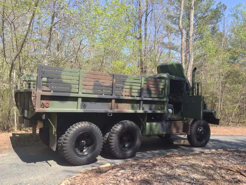

Finally finished all the wheels and hubs. Still have more "spring cleaning" to do, but the rest is a lot easier than than those wheels were.

I spent a solid 12 hours on the deuce today. The left front hub and wheel is clean and painted. I got the right rears off and cleaned, but painting will have to wait for another day. I did get both hubs cleaned, primed and painted. While I had the pressure washer out, I washed the whole truck and did a bit of rust abatement on 3 spots on the bed.
Hopefully one more week of evening labor and I'll have the paint work done.
Looks great, one question? Are you missing a couple of nuts on top of the steering arm? I'm sure it was just the timing of the photo but it was the first thing that jumped out at me.
TMNT
789
Canton, Ga
At the time of that photo, yes. I had the boot guard off at that point. The boot guards were hanging on a wire so the paint could dry. All the nuts and bolts went back on/in when finished. Good eye.

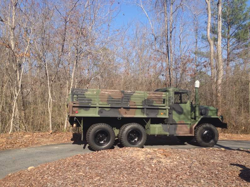

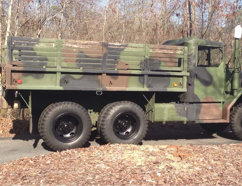

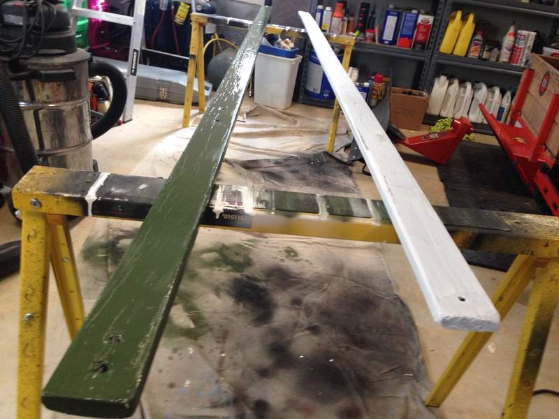

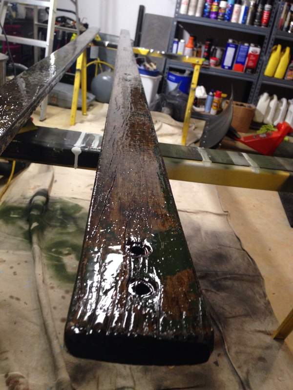

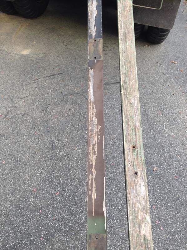

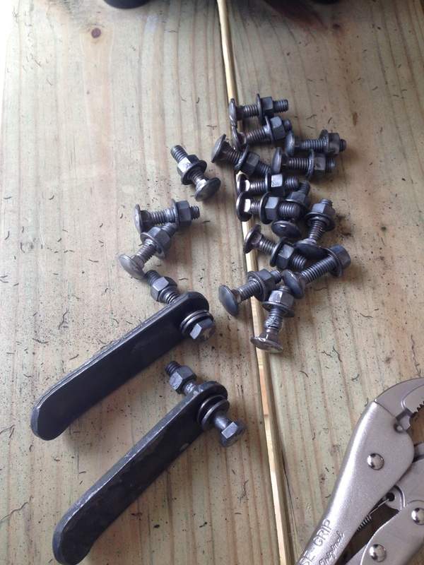

Over the long weekend, I fixed the wooden slats on my troop seats that have been peeling and flaking for a couple of years now.
I removed the two boards, scraped and sanded them to get rid of any loose paint:
Encapsulated them in fiberglass resin:

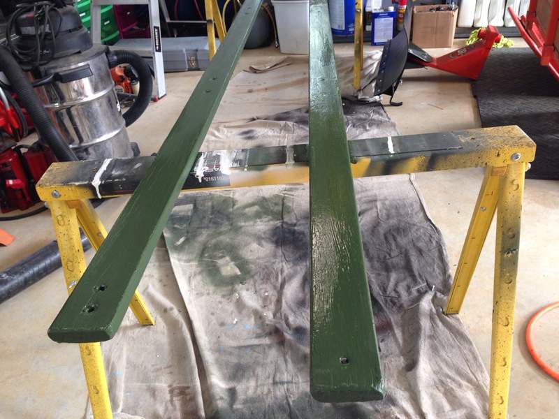

Sanded them, primed and painted:
I also cleaned all the hardware, including thread chasing:

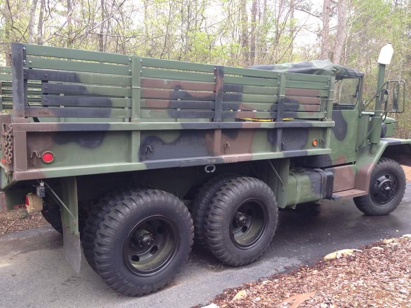

And reinstalled.
That was a lot of work for just those two boards, but I bet I don't ever have that problem again!
TMNT
789
Canton, Ga
The wood was healthy, it was only the paint that was bad. The wood had some weather cracks, but nothing too bad. I thought about just filling the cracks with wood filler, but I spied a can of resin sitting on my shelf and I said,"Why not?"
It rained all day Friday and Saturday, so I needed a garage project anyway. The only problem I had was the resin fumes getting in the house. Boy, the wife was not happy about that!

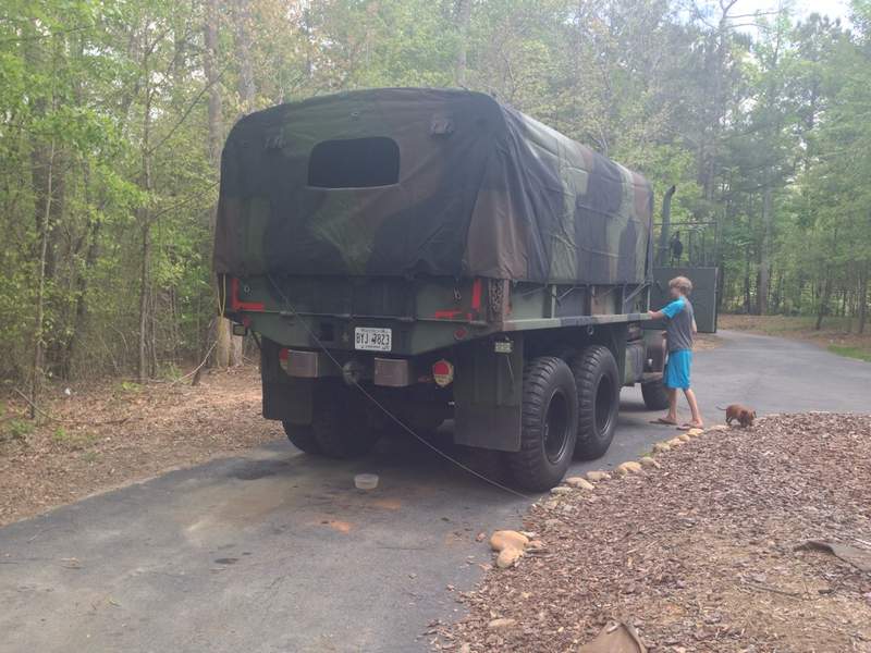

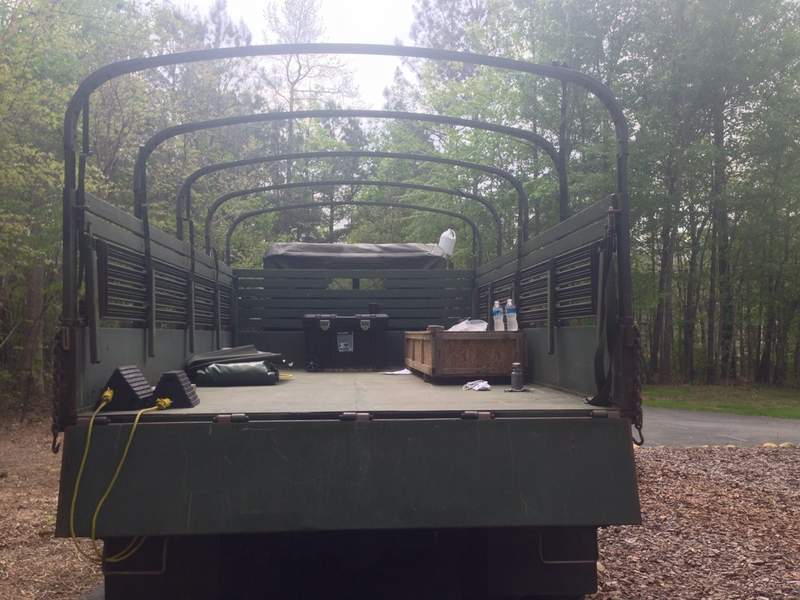

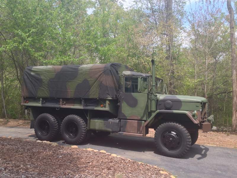

I picked up a cargo cover kit from clintogf while at Zout's cookout. I found enough energy today to figure out how to install it, I think. Kind of tough to figure out the front and back thing, but I think I got it right.
ImageUploadedByTapatalk1398624484.059917.jpgImageUploadedByTapatalk1398624497.513469.jpgImageUploadedByTapatalk1398624506.850660.jpg
TMNT
789
Canton, Ga

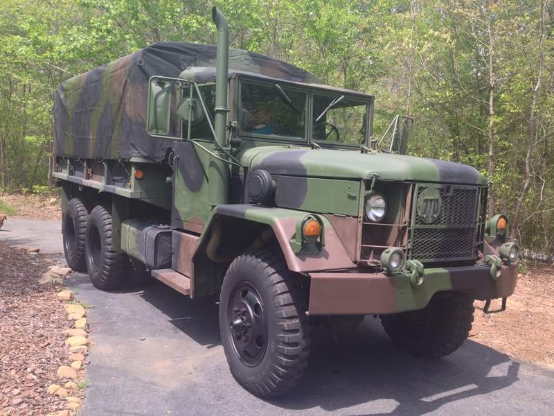

Road tested the new cover and it seems I've got it secured properly. It stayed on at least.
Other than a few extra "pop" noises when the air pressure pops the cover in our out, I don't notice any driving difference. Visibility is actually the same as I very rarely look out the back window. Now it's coming a good rain so we can rain test it.
