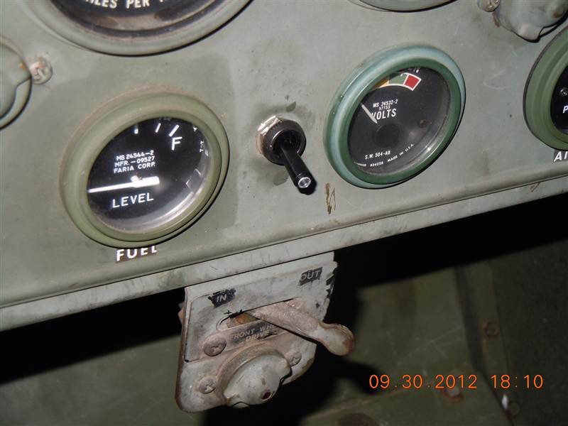

The fuel gauge strikes again! This time I knew I had just filled to the max fill line last weekend. The gauge was indicating a half tank and it started acting like it was starving for fuel and then going ok again. Of course I checked all the gauges and fuel was indicating a half tank. The really dumb part is that I passed 3-4 stations with diesel and I didn't stop because I was thinking I would troubleshoot it when I made it to grandma's house. Well, a mile or so from there, the engine simply died on a hill in traffic. After the traffic cleared, I coasted backwards across a curb and into a shopping center parking lot.
First thing I did was check the fuel tank. Empty! I flipped the power switch back on and of course now the gauge reads empty. I assume that jolting it across the curb shook it loose.
Called the wife and grandad is on the way with fuel. I guess now I know to manually check the fuel level by dipping the tank before I head out.
I still can't figure out how I used that much fuel. I'm thinking I probably got robbed while I was in Florida and the fuel gauge just happened to hang up at half. Live and learn.

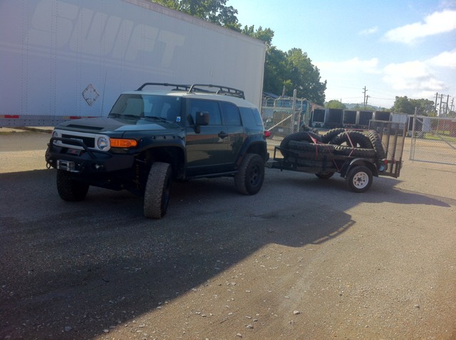

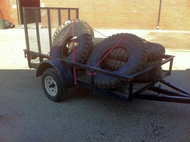

I just picked up 10 brand new Titan T-Hawk 900x20 tires for Big Betty. I got them at Gensco Aircraft Tires in Anniston, Alabama for $150 each.
Good guys to deal with and the tires look good. No cracks or rot at all. They have all the appearances of being brand new tires.
Meriwether Tire in Griffin, GA says they'll breakdown my wheels and mount the new tires for $35 each, but a friend of mine has talked me into doing it ourselves. He has a shop and a lot of experience with split-ring wheels. It'll be a learning (and sweating) experience for me. ImageUploadedByTapatalk1343484246.825941.jpgImageUploadedByTapatalk1343484261.795601.jpg

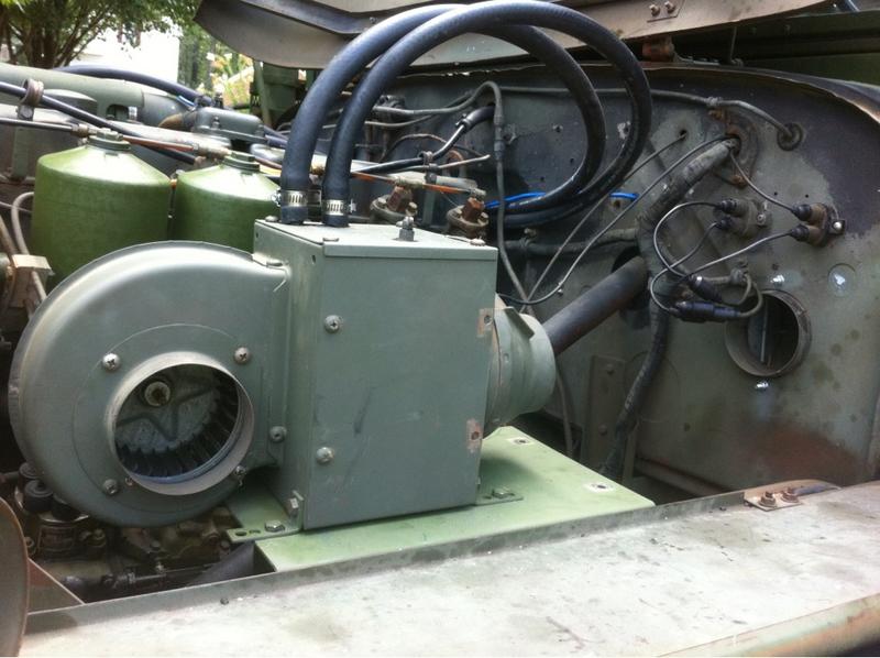

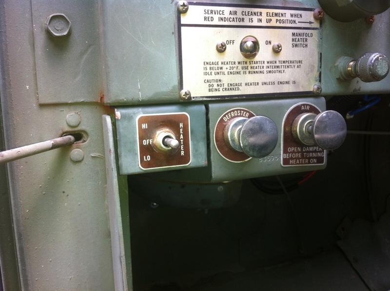

Finally got around to finishing up the heater installation this weekend. Well, almost finished. I still have to install the 4" ducts to connect the heater core to the diverter.
The heater core seems to work just fine with no leaks and making good heat. The blower works on both high and on low.

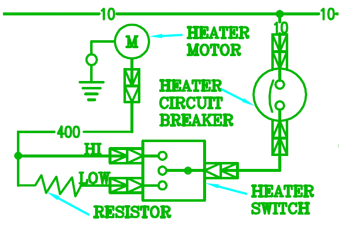

I expected the 5 ohm resistor to get warm in the low speed circuit, but holy cow! It was running about 700 degrees F according to my IR thermometer. Now I'm worried about the wiring and anything within a few inches of it. Jeez, it gets hot!
I wired the resistor in series with the low speed 24v supply. Is that right or should it be a T-circuit to ground? I search the TM's and the forum for hours and I couldn't come up with a wiring diagram for the heater. So, I assumed that high is a direct 24V feed and that low has the 5 ohm resistor in series between the source and load.

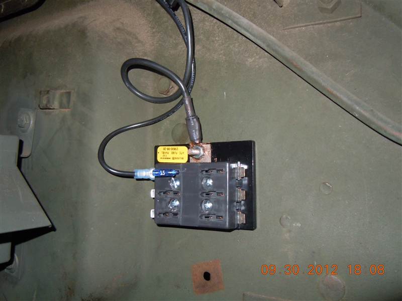

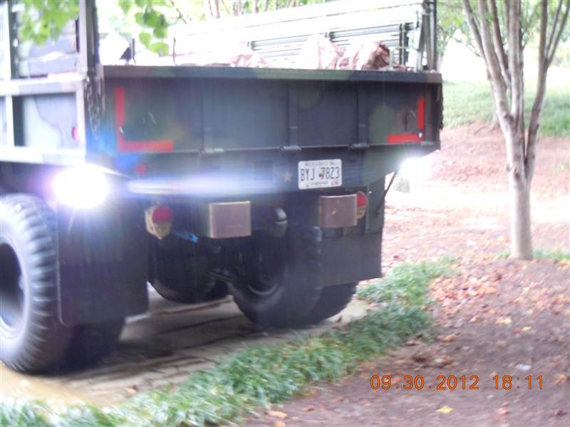

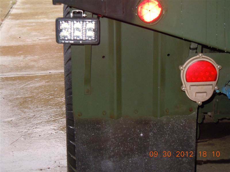

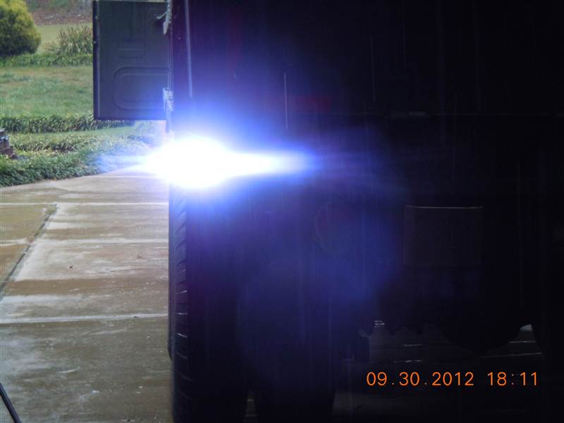

I did get the new LED back-up lights installed. Of course that means I had to insall a fused 24 volt main line to a new 100A distribution buss. The primary fuse is an 80A marine in-line fuse about 6 inches from the connection to the battery. I ran a #10 AWG marine grade wire from the battery to the distribution block. I learned a long time ago, when your installing electrical items in a vehicle, use marine grade components. I typically buy mine from Blue Sea. I also use a lot of copper grease and No-Ox. I got tired of not having a convenient place to grab a new circuit from, so I fixed it.
I picked up the lights from Fleet Pride in Kennesaw, Ga. The lights will operate on 12V-36V and make a nice white light in a broad flood pattern. They appear to be fairly rugged, but we'll see how they hold up.

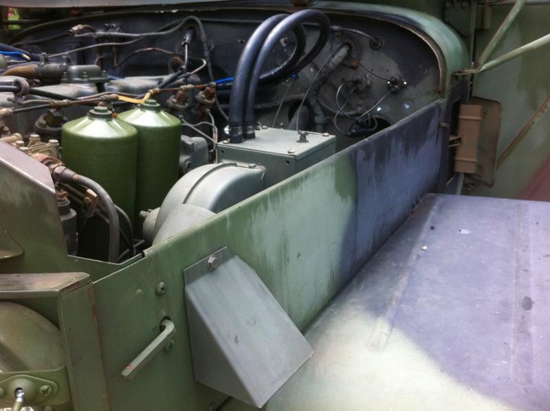

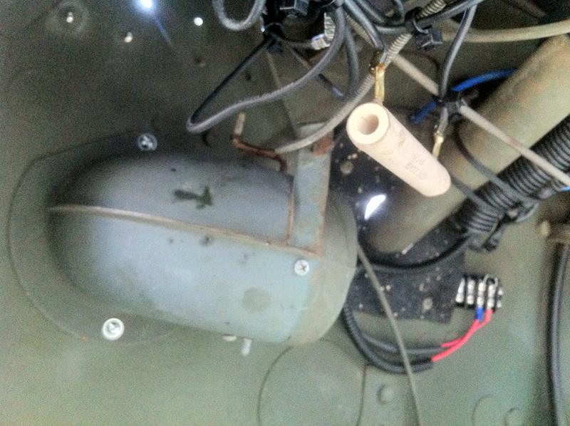

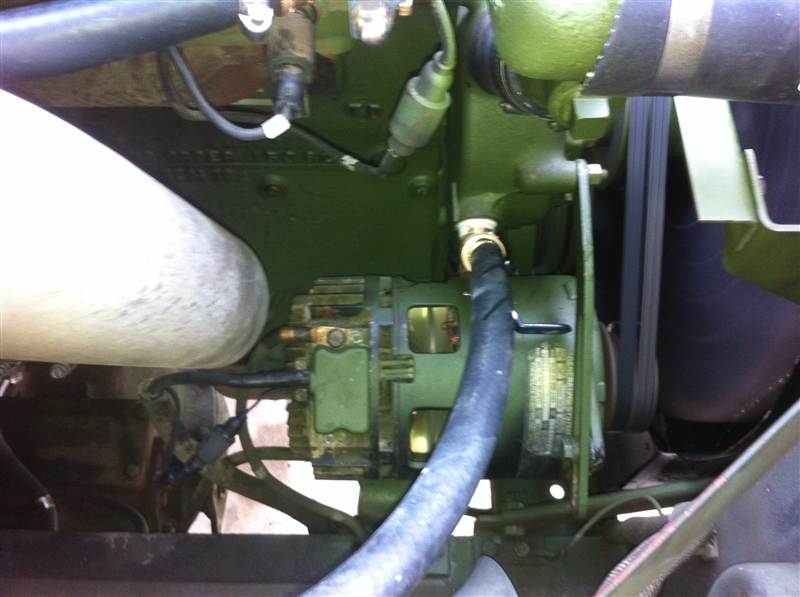

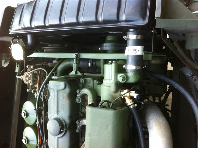

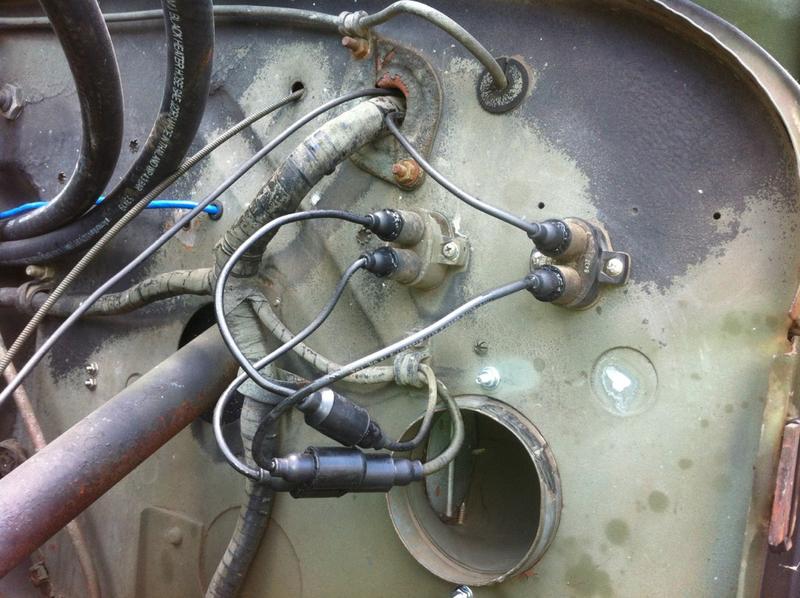

See if these two photos help. I can take more after this rain passes sometime tomorrow. It's pouring now.
One of the connections is just off of the thermostat housing and the other is off of the water pump housing.
I used boiler valvles to provide an "on/off" function for the hot water. The heat pouring through the heater ducts when it's 90 degrees outside needed a solution!

...............I wired the resistor in series with the low speed 24v supply. Is that right or should it be a T-circuit to ground? I search the TM's and the forum for hours and I couldn't come up with a wiring diagram for the heater. So, I assumed that high is a direct 24V feed and that low has the 5 ohm resistor in series between the source and load.
That's correct! (maybe a bit late, but a response, at least...)
Extracted from Peter Bog's Wiring Schematic, below...
