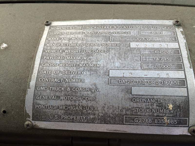

I recently purchased this truck after driving by it on the way to a buddy's house for about 5 years or so. I finally stopped and asked about it and was able to purchase the truck. It has a great running 302 6 with a holley carb. It has an Army plate and says Supply Services Maintaining Vehicle = Army. I am having trouble finding any information on these trucks. I can't find them identified in the vehicle indexes on Olive Drab and they doesn't appear to be any information this site in the searches I have done. I also really can't find any pictures of GMC's with the same grill shell.

I'm gonna step out here and say I think that's a civilian vehicle adapted for some sort of use by the Army for some non-tactical purpose...sorta like the "GSA Fleet Vehicles" used still today. You won't be able to find any sort of info here as an "M Series" vehicle I'm afraid.
I've seen many older International trucks with flatbeds and stake beds
I do wonder who/why the deuce looking bed was put on it. I haven't personally seen that on a GSA type vehicle.
I may be wrong here but I wouldn't think there is anything "rare" about it...especially as a military type vehicle. I personally wouldn't hesitate to modify it to suit my desires/needs.

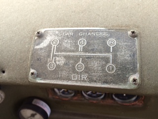

I'd love to try and find out some information on the ratios in the 5 speed so I can confirm what rear ratio I should be looking for. It'll be fun. It looks sinister going down the road for sure.

That shift pattern is the same as the non-synchronized pattern of the Clark transmission in CCKW's. That could be what is in your truck.
I myself would drive the truck around with the 302 and see how you like it. Maybe faster gears in the rear-end. There are performance upgrades available for the 302.

Thanks for that lead on the CCKW. I just read the manual and the information on the emergency brake and regular brakes also looks like what I have or is very similar. It appears that 5th in that trans is an OD and 4th is direct. Also good information on the 6 cylinder engine. Thanks. Faster gears in the rear or a replacement rear will be the first mod with the 302 in place. Then if needed a different engine.
