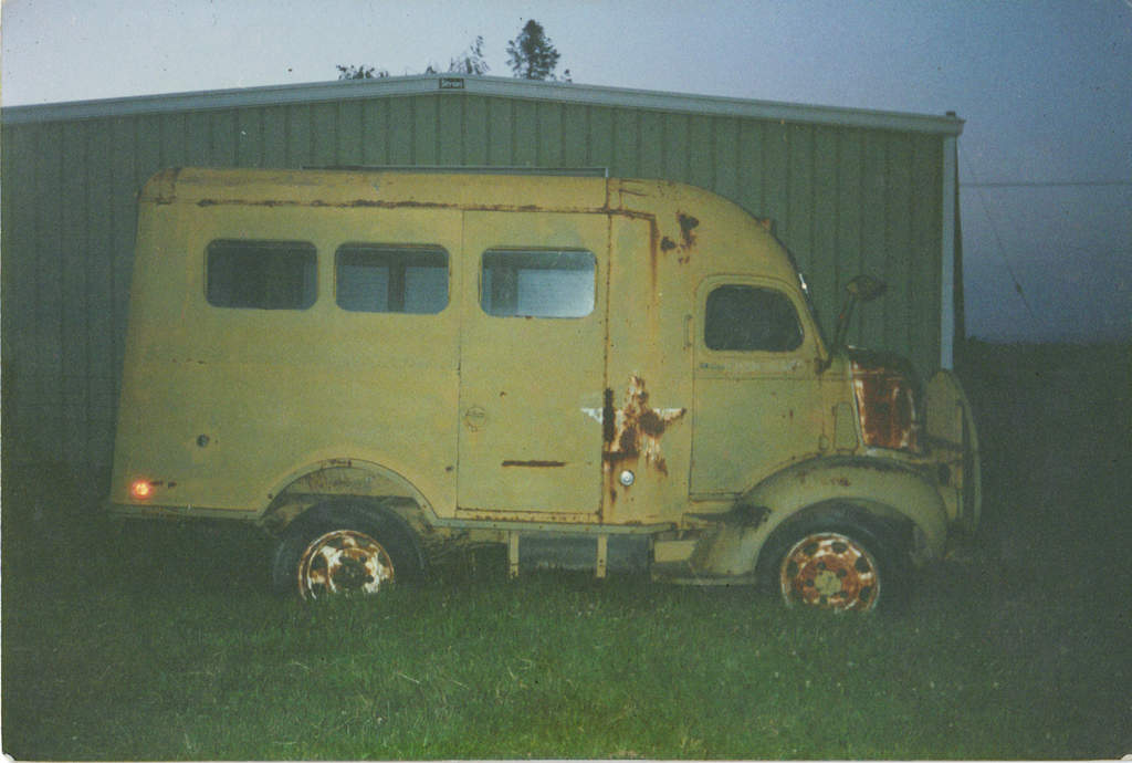

Another angle is that the dash tag identifies it as a G2768 (I think, print is kind of vague). That's a specific quartermaster corps number that presumably has documentation wrapped around it.

Hey Oldfart, check this truck out. Since you were working at GMC Truck and Coach mid fifties can you shed some light here?
I never saw any like that while working there....... However just a few years ago I ran across three of them in a save pile at a scrap yard along with some other military stuff. I tried to buy them, but never could get a firm price. They are a K18 Signal Corps truck that had a companion trailer both of which were set up as airport radio stations. The idea being they could operate at remote front line airfields to provide a semblance of airport control.

My apologies. I assumed the poke from Jollyroger was about the K18 pictured in post before. Upon reading the entire thread, I perceive it is about the 1955 GMC V6 belonging to the original poster. I did in fact see some of these V6 trucks while I worked for GMC back in 1957. The military used them much the same as they currently use Internationals and other brands of civilian vehicles for non tactical duties. They were plated and Identified as military and for the Department that ordered them. I note that the Y in the vehicle serial number does designate 1955. The GMC V6 was a brute of an engine. I can't recall the exact displacements at the moment, but sticks in my mind that they ran from 300 something to the 400 something range. I did also see several of these engines ganged together to make V12's and V18's for stationary applications. I went so far as to enquire why not longer and I was told the combined torque would snap the crank closest to the load. Although I have never seen one, I do know that the V6 block set up was actually cast as a V8 again for stationary power applications.
