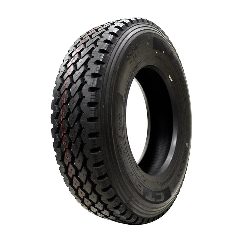

Replaced some tie rod ends with some Moog units. Part #s ES423L and ES423R
Went to aluminum steer wheels and some Goodyear G296 445 65 22.5s. Should last a lot longer than the 395s. 16oz of beads per tire for balancing as well.
Did an alignment on the front end as well. Lost about 300lbs of front axle weight
Picture of a 395 XML vs the 445.
