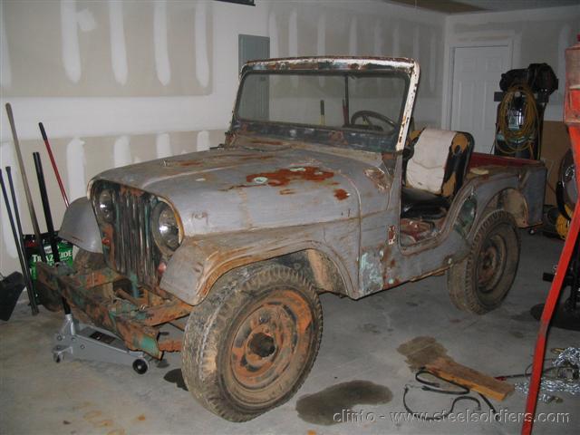

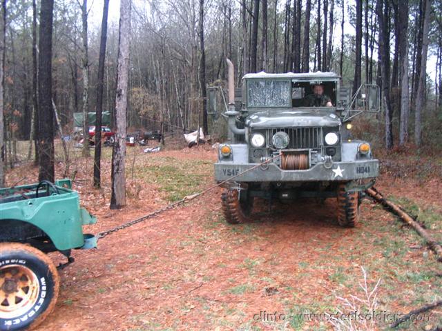

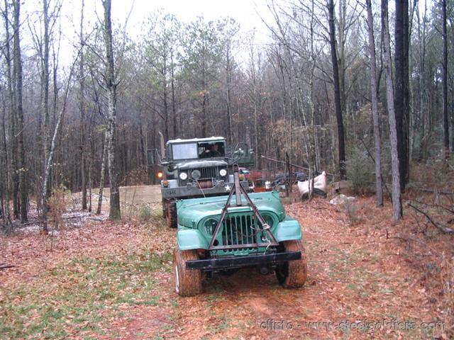

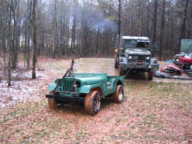

Finally...with the help of a couple of friends, we got it in the garage.
Now the fun begins, brake rebuild, carburetor rebuild, etc. Will keep you updated.

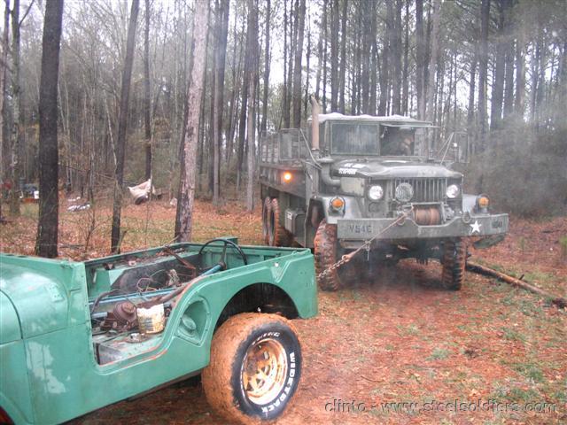

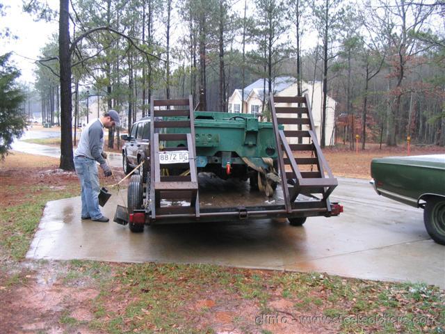

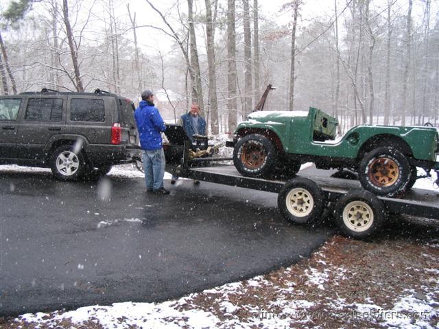

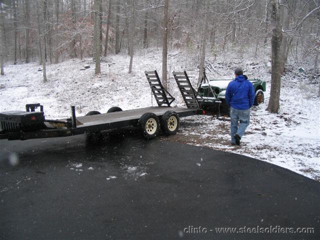

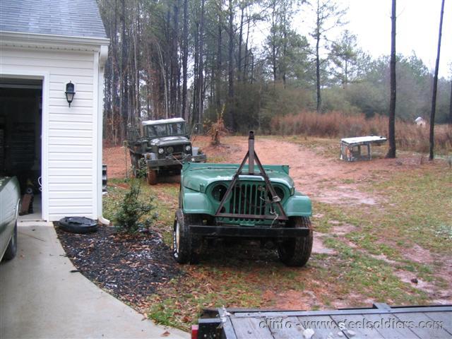

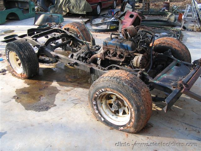

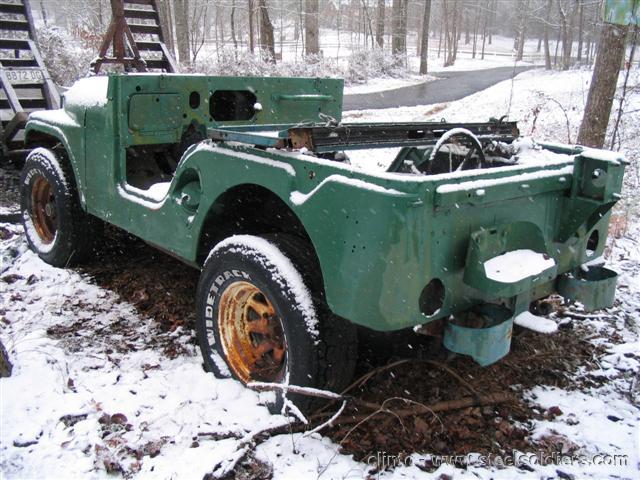

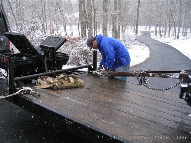

So a couple weeks ago, clinto g/f saw an M38A1 on craigslist. Obviously a parts donor and not a resto candidate, it had some goodies I thought I could use and the price was right. So BFR (my trusty sidekick/brother-in-arms) came down to my house today with his Jeep and a borrowed trailer and we went down to recover it.
Not much to tell, it's an M38A1 that somepne hacked a '68 Ford 302 and Saginaw power steering into. Tub is full of rust and fiberglass, all tranny and transfer levers are locked up, all the 24V stuff is gone....so it's a typical ex-military Jeep rofl
Enjoy the pics.

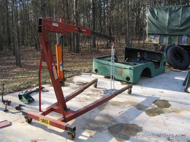

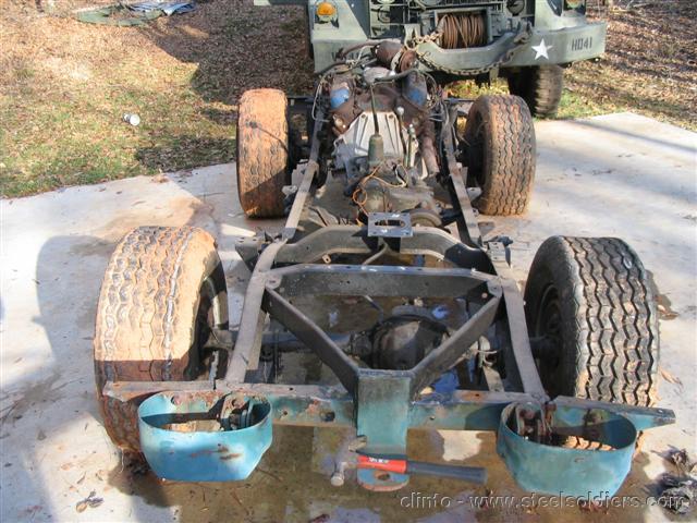

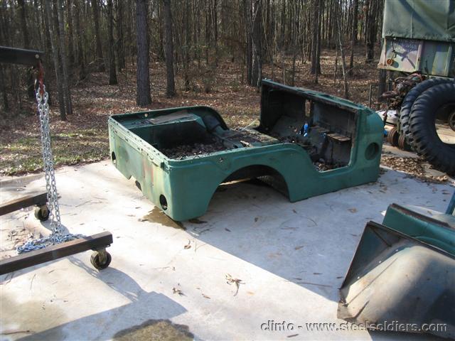

I got some work done on the parts Jeep today............................
I got fenders off and the tub pulled. The tub and fenders are going to BFR so he can use them to restore his M170.
The rest of the Jeep is going to eBay or supplying parts for my Jeep. I've grabbed the M38A1 windshield, rear seat mounts, the fording intake blockoff plate, rear tow hooks, jerry can bracket and spacers, etc.
Man, I can't believe how lightweight this stuff is compared to the Deuce!!!!
