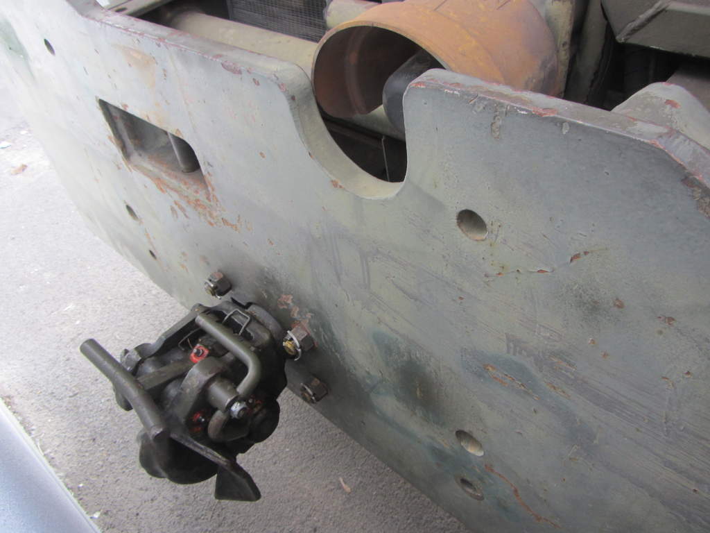

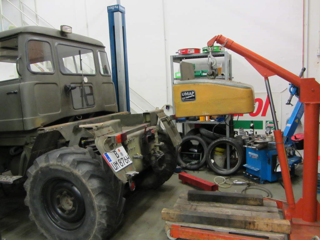

Some pics from the rear axel weight modification.
To get speedy at road traffic we take the original 2 x 1.3 tons weights off and build
a pair of 850 lb/each.
unimog traktor 011.jpg unimog 2026.jpg unimog 2048.jpg unimog 2047.jpg unimog 2061.jpg unimog 2064.jpg

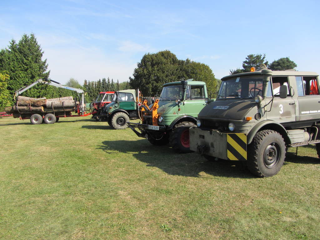

Ready for a funny tractor pulling.
unimog traktor 040.jpg But no chance against the Big Boys unimog traktor 070.jpg unimog traktor 077.jpg :beer:

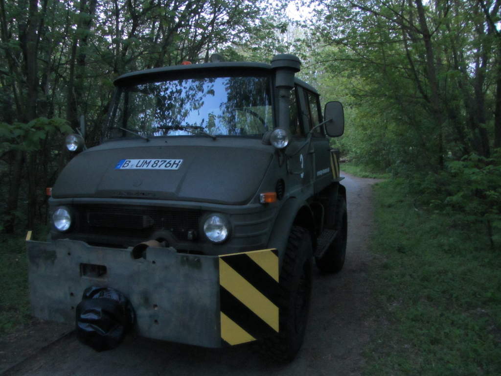

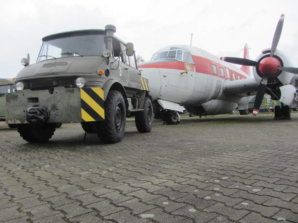

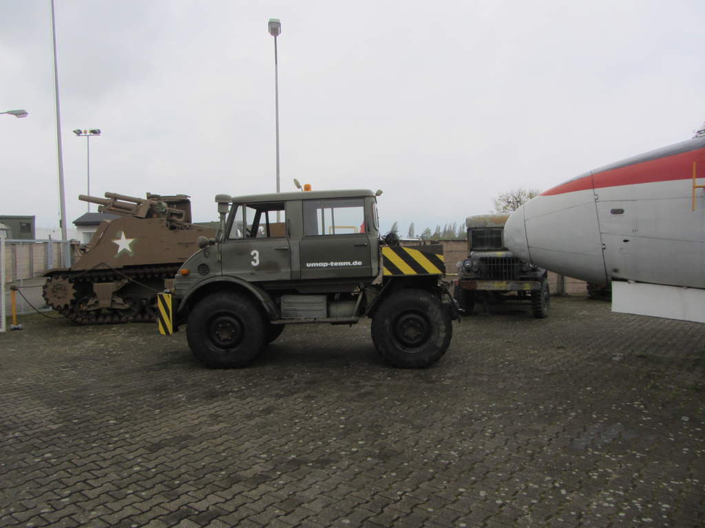

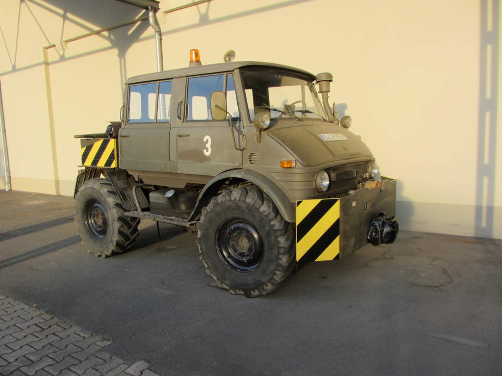

Tug, wheeled, for aircrafts up to 30 tons
Have a nice day, all your MV enthusiasts.
Everyone who cast a vote this month, think about this nice aircraft tug.:jumpin:
Thank you for your vote.:cool::cool: Migginsbros

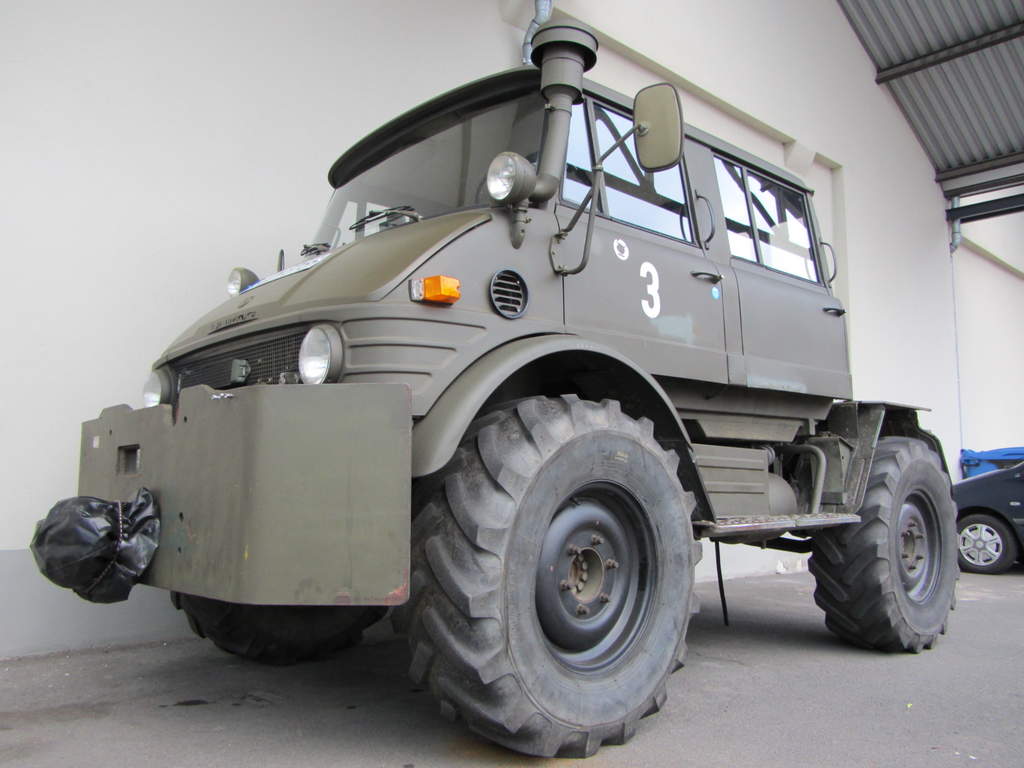

Upon request of thousands potentially voters some detailed pics, recorded today.:jumpin:

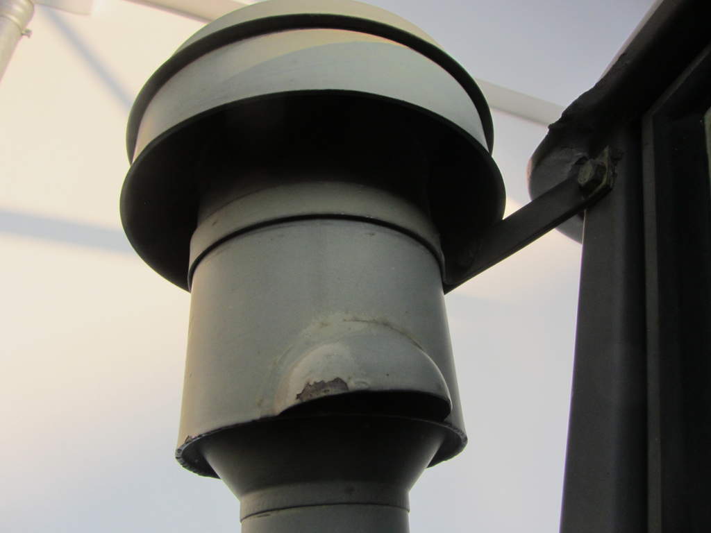

IMG_6243.jpg Cyclon air duct

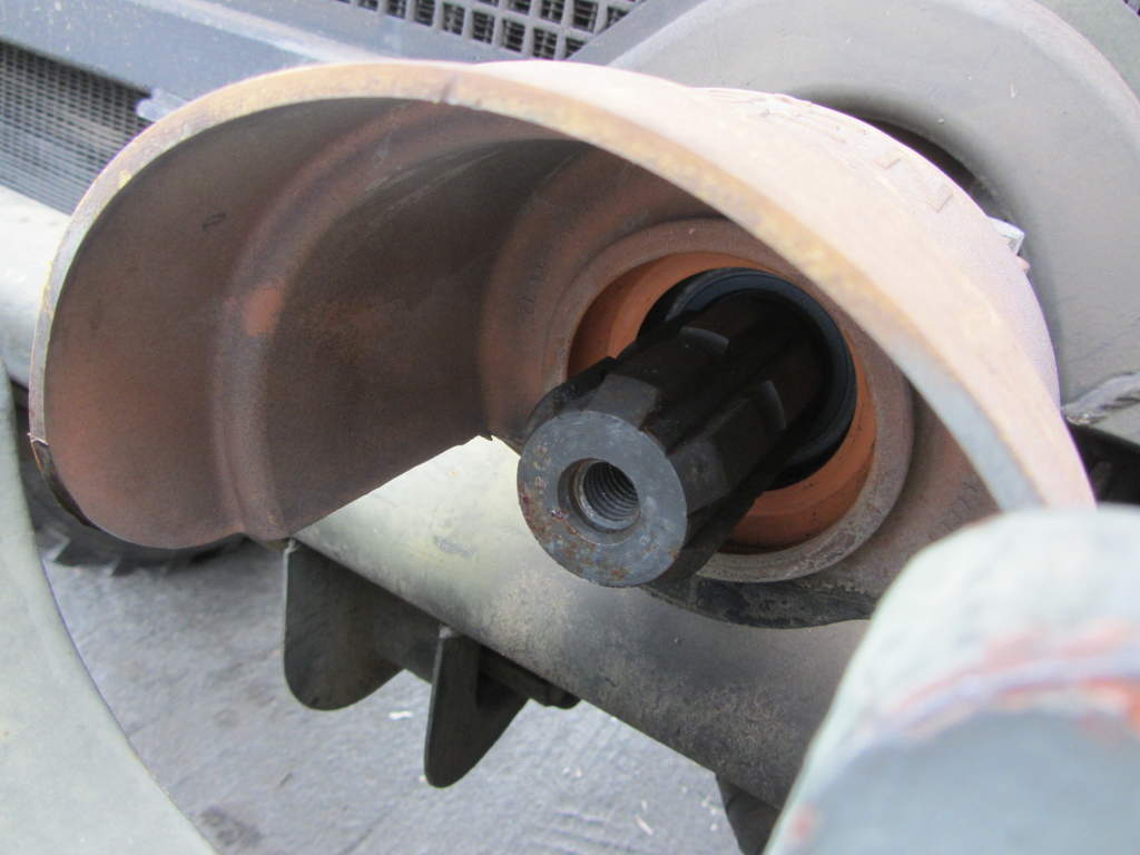

IMG_6244.jpg Front mounting plate with PTO for additional device , like snowbrush

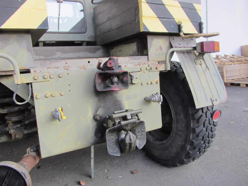

IMG_6245.jpg Pintle hook front....
IMG_6246.jpg ....and rear

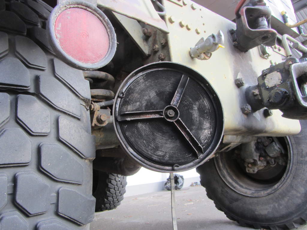

IMG_6247.jpg a screen to prevent getting gloving diesel carbon into wheelhousing of the planes
IMG_6248.jpg 2 fire extinguisher
IMG_6249.jpg Trany/torque converter oil cooler

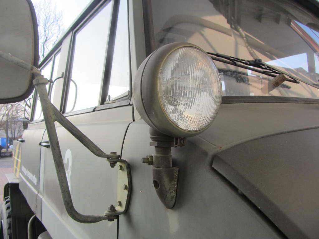

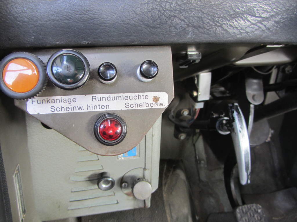

IMG_6251.jpg Additional headlights, used if standart headlight blacked out using a front extra tool

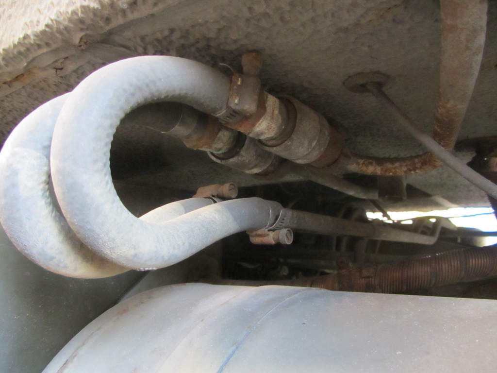

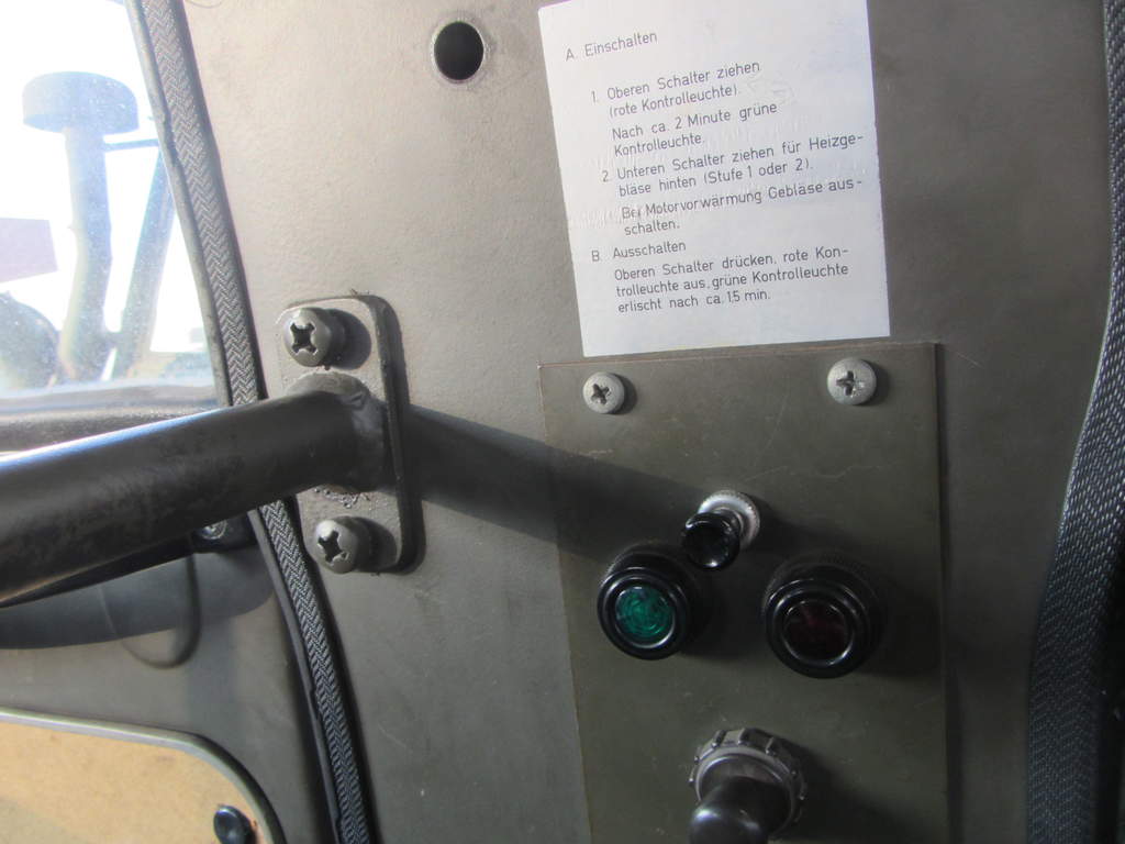

IMG_6253.jpg IMG_6254.jpg Heater with engine coolant heat on drivers side and an additional diesel fire heater under the backseats which also is integrated in the cooling system......

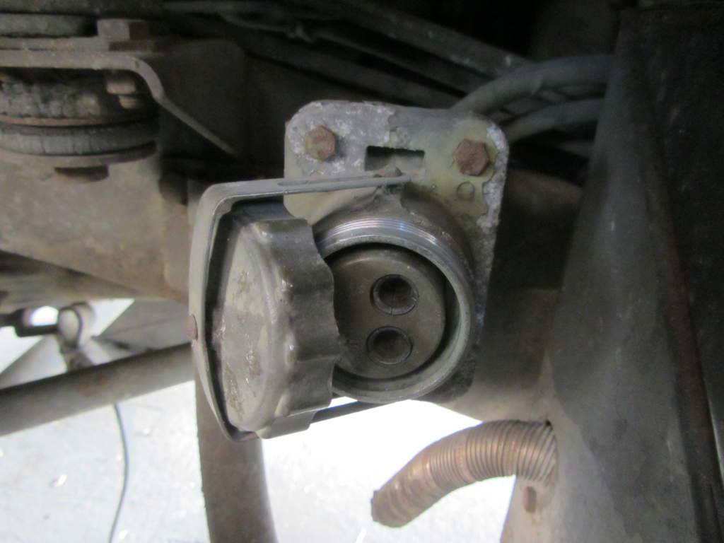

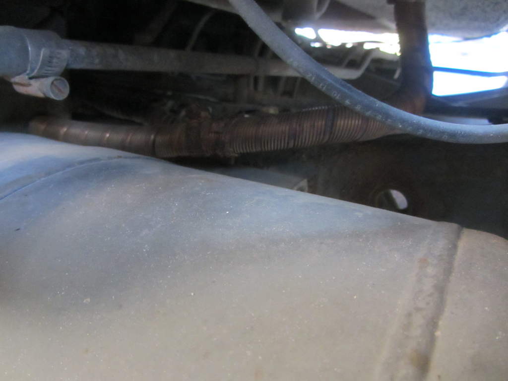

IMG_6264.jpg IMG_6257.jpg IMG_6258.jpg ... and below the external 24V receptacle you see the heater exhaust tube, routing across the batterie box for better cold cranking.

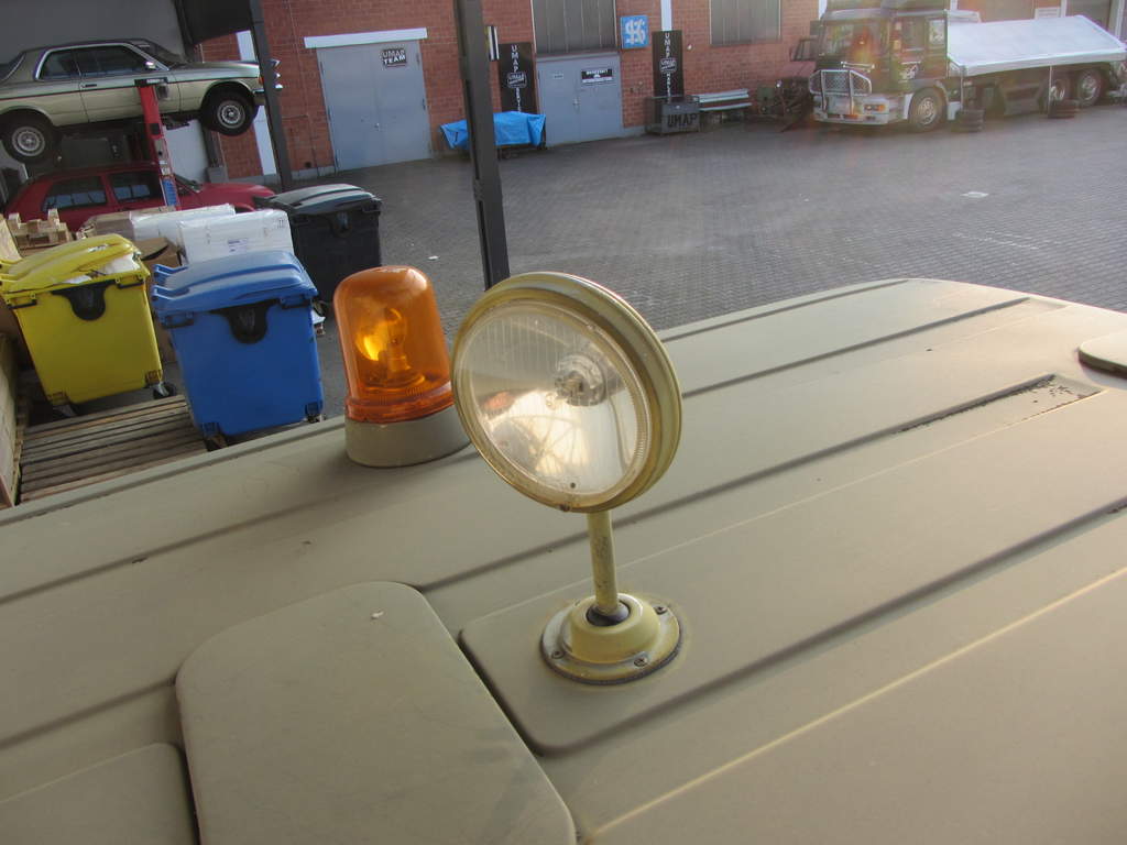

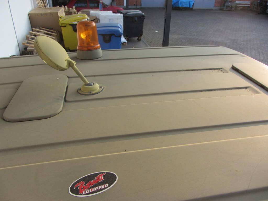

IMG_6256.jpg IMG_6255.jpg ... the two roof vents, the convoy light and the movable spotlight

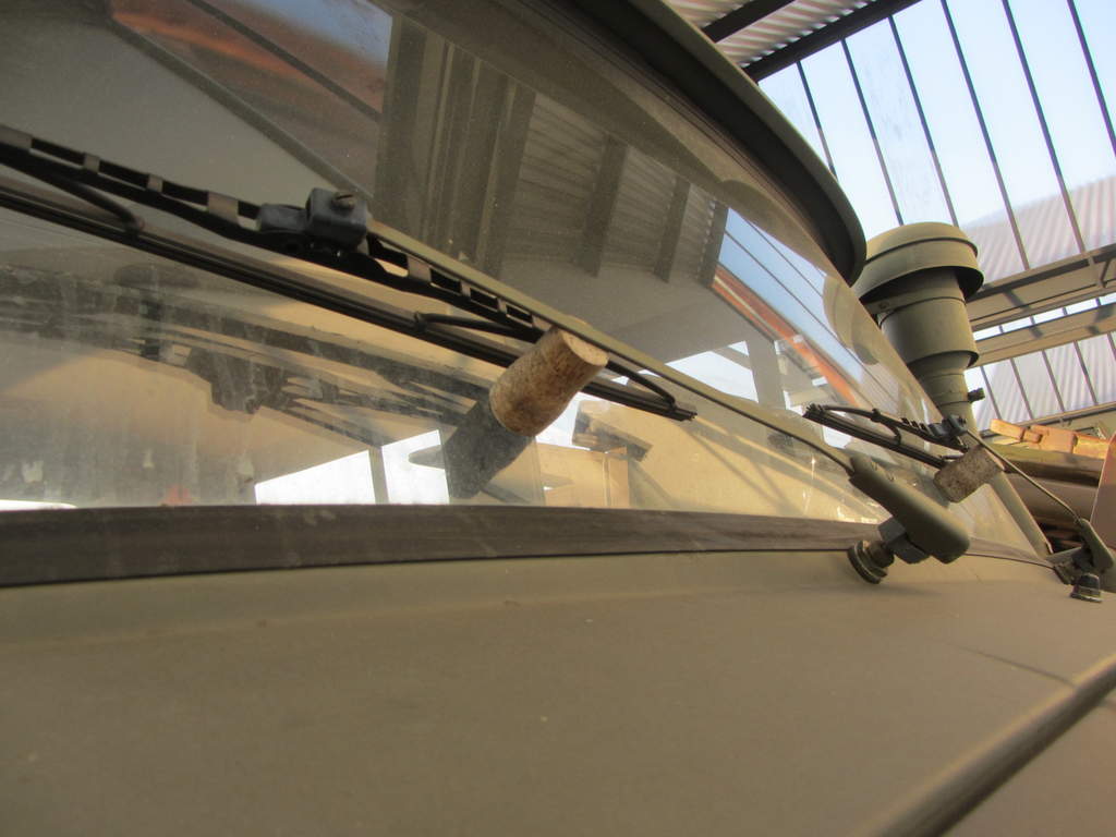

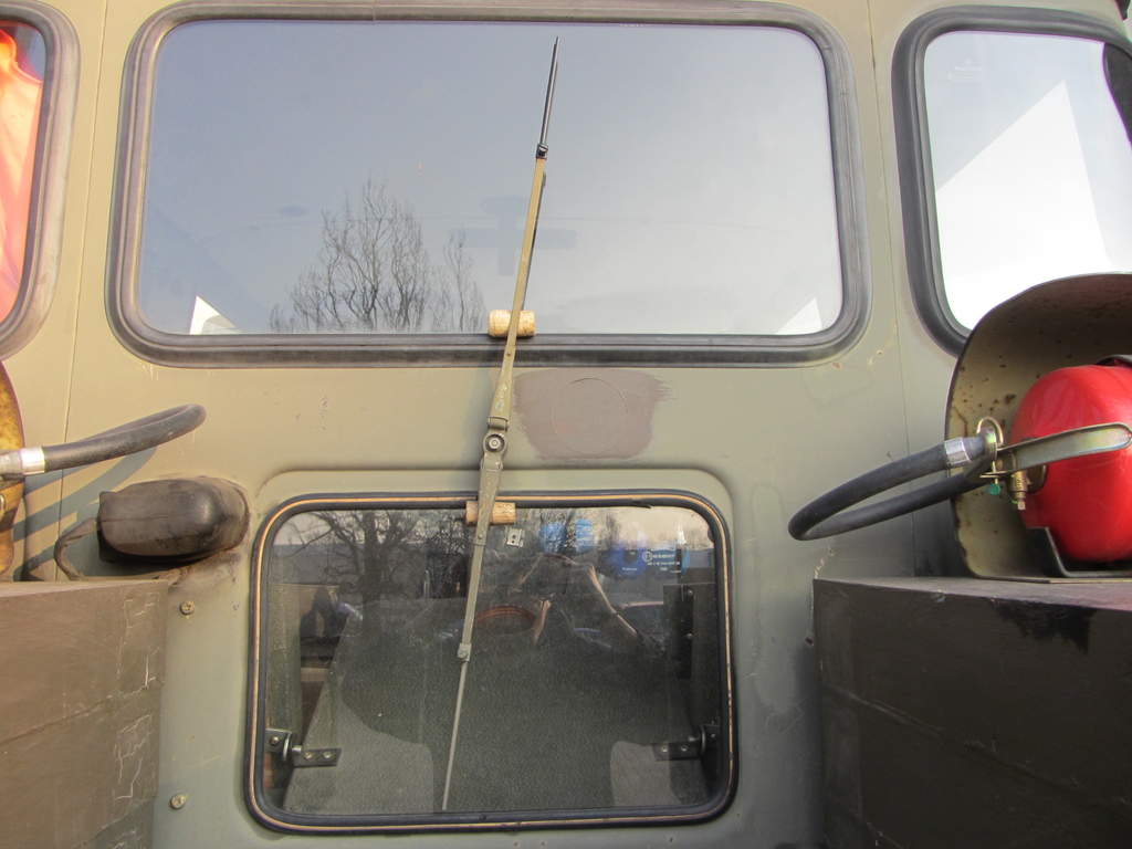

IMG_6250.jpg IMG_6261.jpg and last but not least.....don´t forget to put some wine bottle plugs under you wipers.:tank::tank:
Migginsbros UNIMOG 406.145 aircraft tug.:beer:
