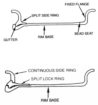

So Hemtt rims even though they are in 2 pieces are not considered split ring? Could someone please post pics of a regular 2 piece wheel and a split rim w/ lock ring. I've never seen the difference so i'm curious.
And technically shouldn't all tires for these trucks, since they are big enough, be inflated in a cage regardless of the rims they are being put on?
http://www.cdc.gov/NIOSH/FACE/images/03ak006a.jpg
Here are two pictures of the dangerous ones. They have proper names, but you will hear the names used interchangably.
The top picture you will see the style of the factory Deuce and a half wheel, the lock ring and the outer flange of the rim are one piece. These are somewhat dangerous and need to be respected.
In the lower picture, you will see a three piece version of the same. The outer rim flange is one solid ring, held in place by a separate locking ring. These are "Widowmakers" and they demand respect.
The "other" wheel very commonly referred to as a two piece wheel or a split rim is somewhat different. These consist of bolted together wheel halfs, or else a nearly complete wheel that resembles either of the lock ring types, but instead of using a locking groove, the outer wheel flange is actually bolted to the wheel center. The danger with these (assuming all the hardware and service procedures are sound) is pretty much comperable to a standard one piece drop center wheel and tire assembly. This one looks as if someone's burning a broken stud out of one-
http://www.explorerforum.com/forums/attachment.php?attachmentid=34666&stc=1&d=1154894129
Technically... All tires should be inflated in a cage, but realisticaly it is accepted as an acceptable risk with acceptable consequenses for most automotive tires and a cage is not used. The larger the tire, and with wheels other than one piece drop center rims, you are more likely to see a cage used. In commercial use it is required.
As to the original post, either style of lock ring wheel becomes dangerous when the tire bead that should rest on top of the locking ring is dislodged from it. If the tire is 100 percent in place, inflation will be a non event. (Even as such, I must say that I am usually on the opposite side of the truck while they're inflating...) If you have not seen a rim of this style taken apart and assembled, I would strongly recommend the suggestion above. Take the first one to a pro, but first make sure that pro is willing to let you actually see what is done. having your own eyeballs on the process lets you see both how simple it is, and how critical it is that critical items not be overlooked or ignored.
