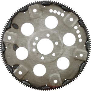

Same here, Flexplate will be in today from RA 35$. A friends shop will be doing the install, not to excited to see the bill for it thought.:-( My truck has been making that noise for 3 years and now its to the point where i have to crank it with a breaker bar to get past the broken teeth, its like an old airplane now!
Sounds like you need a flywheel flexplate. Sorry to say that horrible sound means teeth are missing on the flywheel flexplate.

Sorry to hear that. You don't need a lift or any special tools to change that flywheel / flexplate. Just put 4" long grade 8 3/8" bolts at 2,3,9,&10 oclock on your bell housing bolts. Disconnect everything and slide the whole assmbly back and reach up in there and change the flywheel / flexplate. Save the cash. You can do it on the ground in about 3 hours with basic hand tools and a floor jack. Just an idea. Do as you wish. I wanted to share that. That is what the site is about. Saves lifting and relifting that heavy transmission and tranfer case assembly. You can even let the crossmember attached. I hope that helps.

I know that I am capable of doing the job, but with it being my main transport, its cold, and I am very busy, the easiest thing for me to do is to drop it off and pick it up at the end of the day. I hate spending the money but sometimes the convenience is worth it for me.

You need to slide it back, but not really drop it. Just support it from beneath. Shouldn't even need to remove the crossmember apparently. Read recently that it's possible with basic tools in about 3 hours.

[h=3]Pioneer/Flywheel - Automatic Transmission[/h]
Fits Your Vehicle
This product is a fit for your:
1984 Chevrolet Truck K30 1 ton P/U 4WD 6.2L Diesel 8cyl
Autozone $45.99
No you do not have to drop the transmission. Just check out Post 1322 in this thread. You need 4 - 3/8" X 4" long grade 8 coarse thread bolts and a floor jack and basic hand tools. About 3 hours and a pair of coveralls if it's cold and you need to do it outside. Get a sheet of plywodd to lay on and roll the floorjack.

Well thats great news. But i will have to drop the transmission right? Also. Is there only 1 model. Or is their a certain tooth number for the cucv ?
Search here on SS for threads on this. Many just get some longer bolts for the trans-to-block, and then just slide the trans back far enough to get to the flexplate...
And it is a stock part, nothing special... GM part number is in the parts TM, and can be crossed at just about any decent auto parts house.
