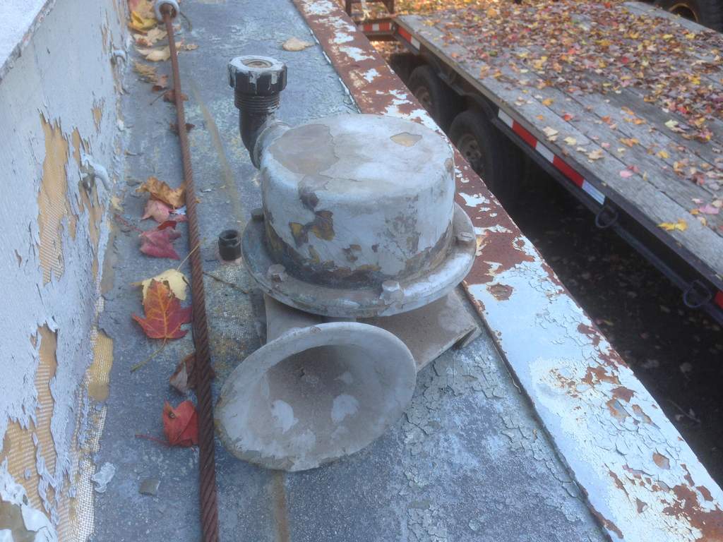

While back up at the former home of the boat I mentioned some of the parts that were missing to the owner's son, including the original horn. He said he saw a horn somewhere and there it was right on a shelf, so I'm pretty happy about that. Probably not the easiest piece to find, it's 24v too.

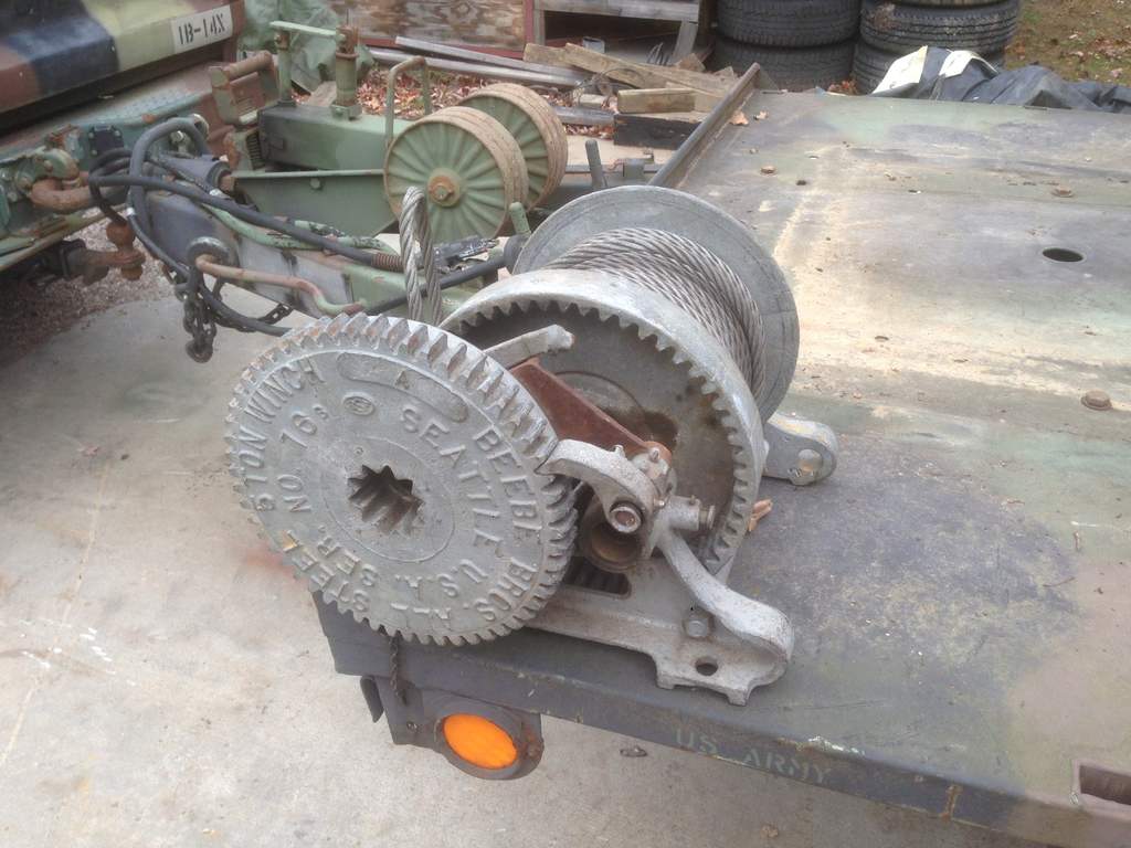

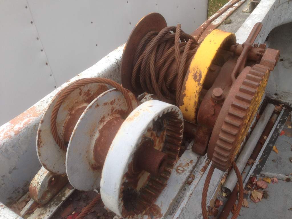

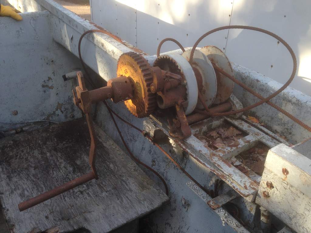

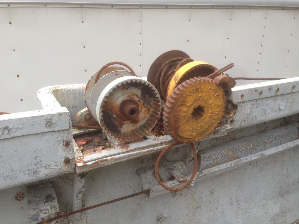

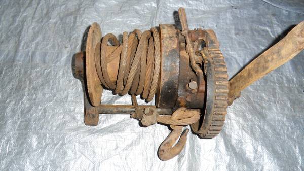

I've got a winch that I think is the same style as the original sitting in Eastern, CT. Hoping to find someone here that could pick it up. If it works with the drum I've got on the boat then I'd have a working winch for the ramp.

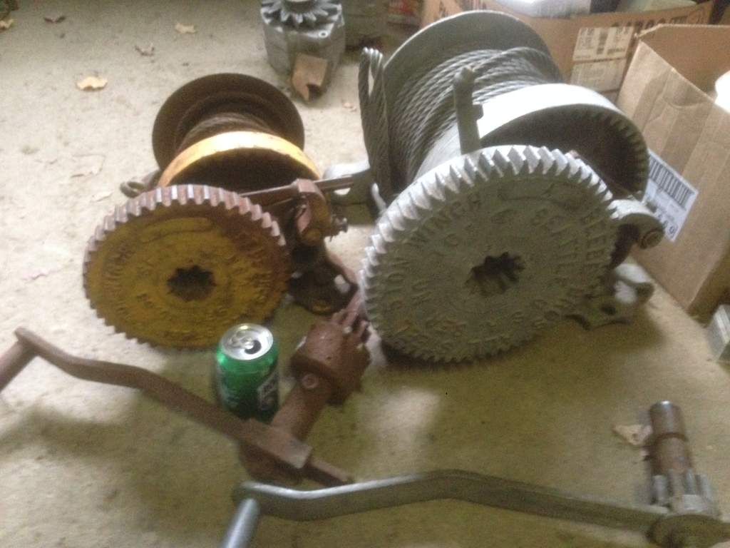

I still need the winch pictured above picked up but I just got another one of the same size, it's a 2 ton Beebe Bros winch. Luckily the 2 section drum is still on the boat as that seems hard to find (but easy to make), most I've seen are just setup for one cable. On the LCVP the Starboard side of the ramp cable is wound from the bottom of the drum while the port side is wound over the top, traveling though a couple sheaves around the stern to get there. This way they both work in unison through one winch. Once we clean up the yellow winch and swap the drum with the one on the boat we'll have the correct setup. Also pictured is the 5 ton version, not used on the boat but I had to have it.

The winch works like it should. There is only 1 ramp cable still together and it's all rotten so we didn't lift the ramp very high as I'm sure it'd still hurt a bit when the cable breaks and hits ya.
