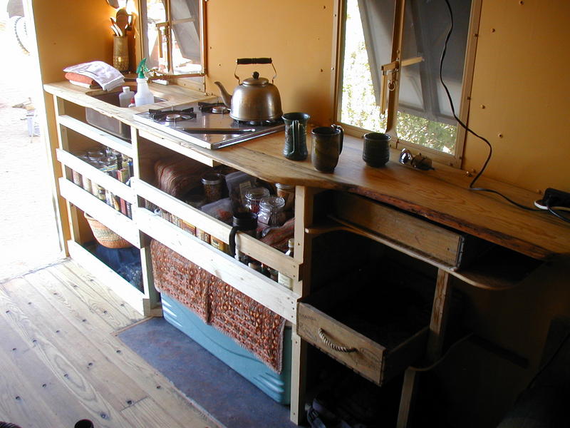

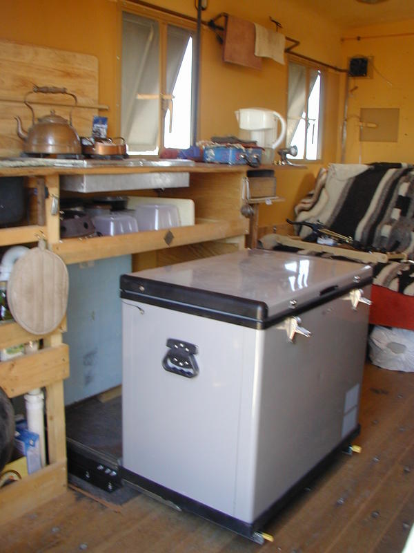

Now it was time to get rid of the cooler, . . . no more looking for some place to get ice, or draining the water out of things that should NOT have made it down to the bottom, . . . dealing w/ moldy experiments when the cool leaves and we're still days from an ice vender. That's right, we're cutting the last umbilical cord that keeps us running back to some vender for supplies twice every 7 days.
This is what I'm pulling out (just the section under the stove top).

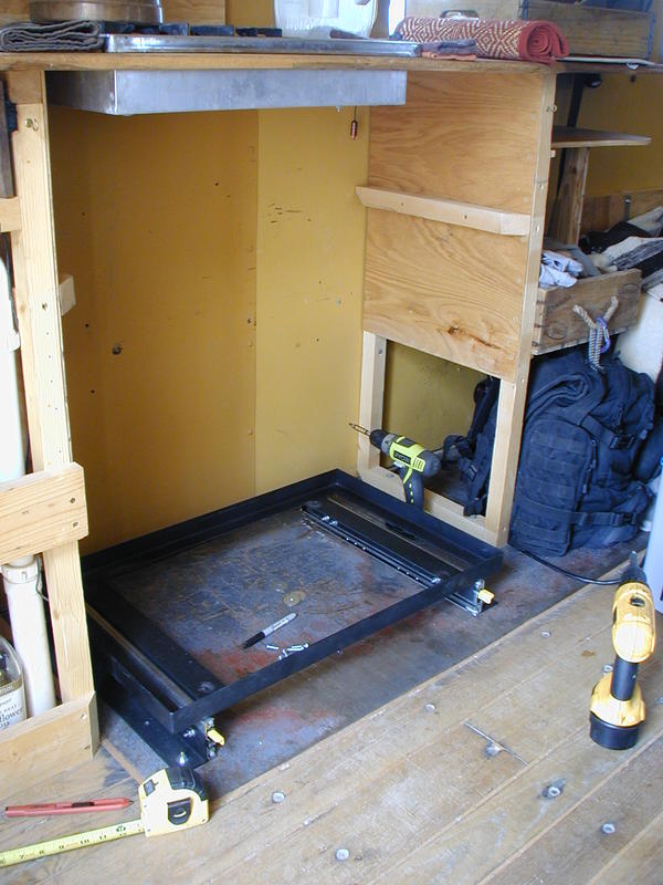

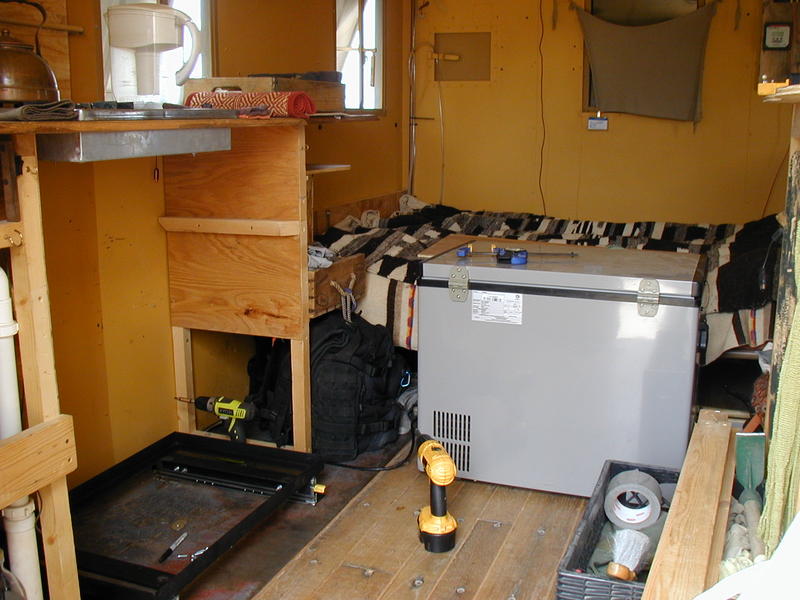

Started by having a frame made to hold the new unit, then I mounted it on 500lb locking slides. I picked "full extension" 20" even though the unit is only 18" deep. That will give us the ability to pull it all the way out from under the counter for loading.
Being that it does stick out farther than the counter by a few inches, I made it so that there is room for our feet to go under it. Didn't want to have to lean over when cooking :)
It's also spaced 4" from the wall behind it. That will let me fill that space w/ foam board, still leaving an air channel of 4" going to the air intake.
Next will be getting the insulation in behind it and on the floor under it.

Is that a propane fridge? Jim
Nope, AC / DC 12 or 24. We'll run it off DC most of the time. No need to be level, I think it's rated @ 1 amp draw (would have to look again), fridge/freezer. It's the style that the "expo" people have been using :)

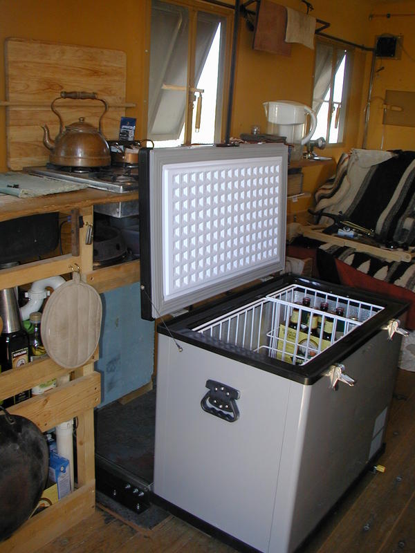

12v / 24v fridge
What's the make and model of your fridge?
Thanks much.
Man. That's amazing !!! Only 1 amp draw ??? What do that set you back ? I'd like more details on that too please. Thanks, Jim
That's how they rate it on their spec sheet. Now that I've got it wired in to the 12v I can see the draw, it draws around 4.6-4.7 and then drops to nothing. It runs in cycles like that. Don't know the timing of the cycles, or how temps affect the cycles yet. Will know more on that as we use it.
It's a EdgeStar FP 861 (not the top of the line name, but not the worst) 83 quart.
it's spec'd at 1A, 80W.
Cost - could ALMOST get a 4 set of 385's at a good deal, could def get 3

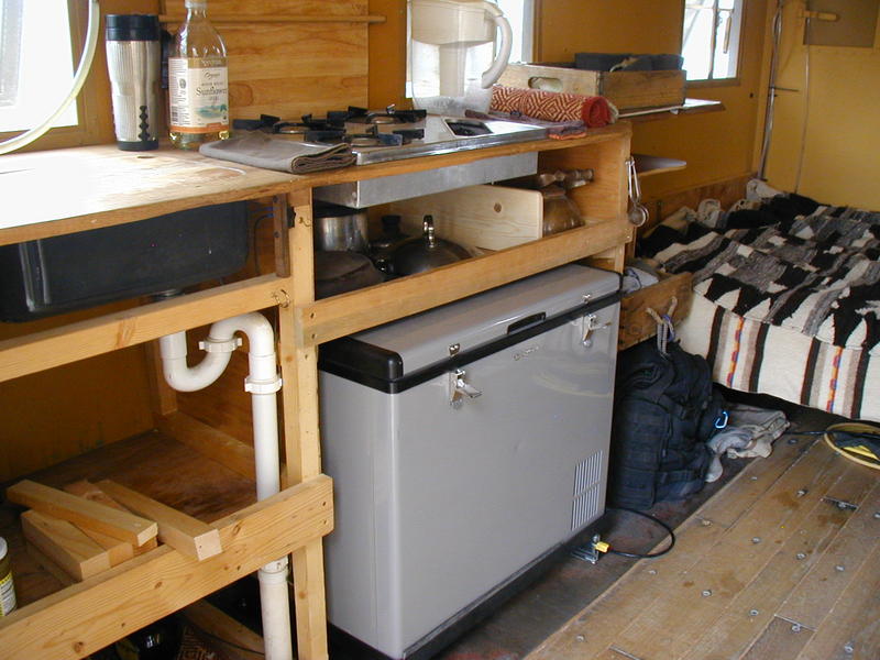

Yesterday while working in the truck I noted this,
I have the unit set at 50deg, which means it cools down to 47deg and waits till 52deg to start again.
The inside temp was reading 105.
It would run for about 7 mins to reach the low of 47deg,
it then took about 25 mins to warm 5degs and would start again.
During the run time it would avg about 4.6, but I did see it get to 5.9 at one point (just for a moment)
This is w/o having insulated the space that that it lives in, or adding a axill fan (which I'm planing on)

i don't mean the insulation around the fridge...the internal insulation. pulling the warm air away (and out of the truck) is a good idea, i think so.
look at this : Sundanzer Solar Refrigerators and Freezers | Sundanzer.com 110mm insulation.....
59, I understand and agree. I'm just adding to the insulation by making an insulated space that it slides into. As far as the air flow, they are made so that the air flow exits on the side that the lid opens on. Right, it blows into the rig. They require 4" "behind", between the wall of the truck and the back of the fridge for air intake. The right-side also has some air intake space, but the main one is behind.
So my plan is to insulate it on the left-side and along the back, till it gets to the air intake, w/ 4" foam. I'll then make a channel that runs the right-side and around the corner to the back intake. Then add a case fan at the front end of that channel to "ram" air into it if needed. I'm guessing that it won't be needed (just from the amount of heat that it gens while we are triple digits, not a lot) but it's a cheap addition.

i'm not shure, but i think that don't works....a fridge need space and air around it to work properly. youn need air inlet and outlet....the compressor gets warm....maybe it dies from heat in an insulatedt box?
LowTech
886
12
Arizona
It does work and has been done before. I have not blocked any air flow, that's what the "channel" is about. It allows air to get to all the intakes, and the exit blows toward us. If the "intake" is not getting enough air, we can use the case fan to push air to the intake (kind of like a turbo, only using electric instead of exhaust gas)

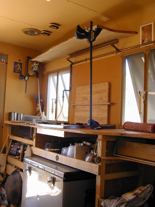

Been on our summer "road trip" (maybe I'll start a thread on that ;) ) and not really had time to update the build.
Here's some more of what was done,
The fridge in it's final, non-insulated floor, state.

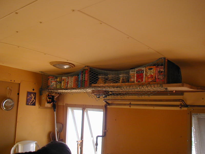

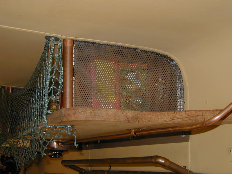

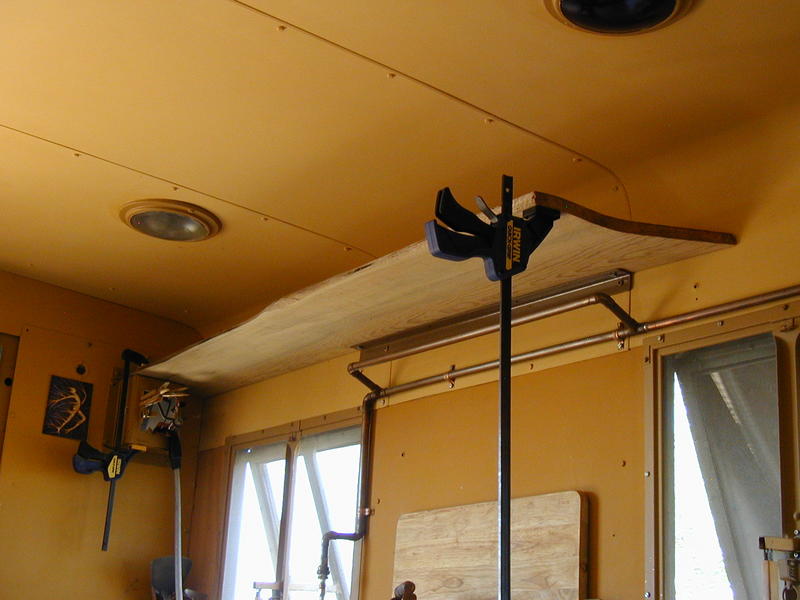

To make up for some of the space that we lost upgrading to the fridge I started our upper shelf / exhaust hood. It comes from the same slab that made the kitchen counter, in fact the end cut still matches to the counter.
Had a couple divider / supports made by the man that does most of our metal work. The copper tube has all thread going through it into the roof rib.
I did a quick front edge & netting to keep it all in,
