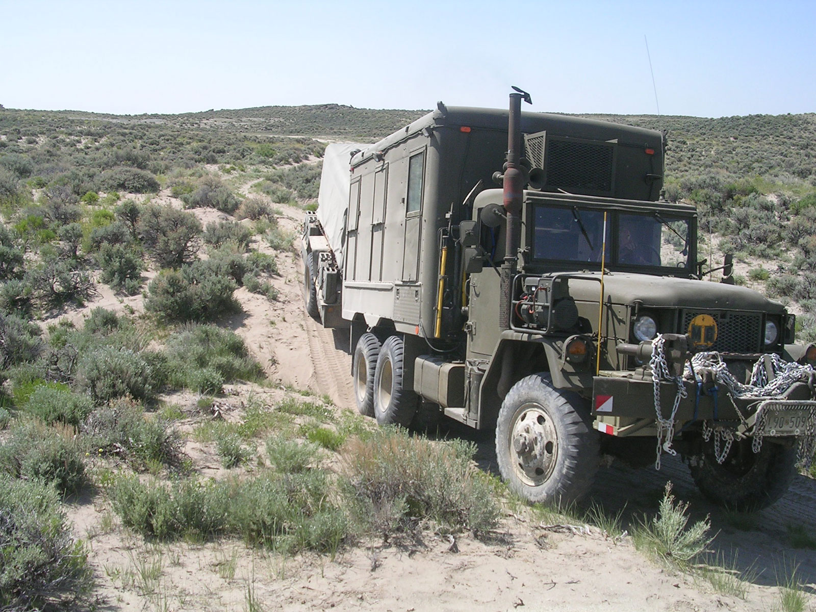

I would if I were you wire the shelter for 110 volt AC preferably with a changeover switch from a M-109. The changeover switch changes from the truck 24 volt system to an outside power connection for commercial or generator power. The changeover switch has three positions 24 volt....all power OFF.....and 110 volt.
Reason...If you truck + RV has commercial power wired in permanently. It is one of the criteria the State DMV's use to determine if the vehicle is an RV. AKA an M-109 is registrable as a RV when it comes home.
Food for thought.
That is a very interesting comment. Camping world has the entire 12v/110v system prewired with an inverter for about $200. I have been torn on weather to do that or no since I probably dont need the 110 for the most part..... But....Putting in 110 is pretty easy and because of that, I probably will add it. I considering using jump start connection on the duece for the shelter since it is not hooked up in the duece anyhow and the shelter came with the matching plug to fit that receptical.
Definately leaning toward 12V & 110 in the shelter.
There are 24 volt DC / 110 AC inverters out there so you could wire up the truck's electrical system with a DC-DC charger to charge a 24 volt battery bank and keep commonality with other 24 volt hardware on the truck.

Another Progress Report:
Bed in place, painting to come
Shelter Bolted to duece bed with 8 qty. 1/2" bolts
Window alum. will be painted OD green
I was able to get fold down table/benches from an RV that I may use (stacked on upper bunk) I also got 7 brand new RV lights from the same person I will be using rather than the LED's since I got them cheap.
Electrical and Plumbing will be coming after a little trim work and some painting.
