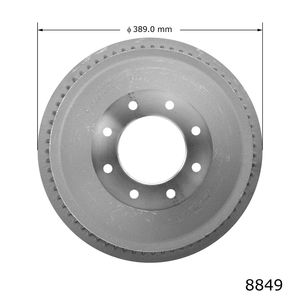

I new 2 GM CUCV M1008/M1028 rear brake drums. I know some guys do disc brake conversions. I want new. I have several used but I want to put new ones on. I will resort to Autozone drums if I need to. I have used them in the past and had no issues. I was needle scaling these today and after I was done with one it did not suit me. i need to get these axles completed. It may not be feasible to ship them. I think Autozone drums are less then $80. each. Thank you. I was incorrect. They are more expensive then I thought. I think the CUCV has the 3 1/2" brake shoes. I am not in my garage. I can check tomorrow after services. Have a great evening.

[h=5]Features & Benefits[/h] Duralast brake drums & rotors are precision engineered to meet or exceed OEM performance specifications. Cast to OEM design & SAE J431/G3000 metallurgical specifications. Designed for optimal stopping, longer life and greater resistance to warping.
  • Vent rib count, size and pattern matches OEM specifications
  • Follows OEM specifications for iron plate thickness and air gap
  • Non-directional surface finish does not need to be turned prior to installation
  • Machine balanced to deliver smooth stopping
[h=5]Product Details[/h]
Part Number: 8849
Weight: 53.75lbs
Warranty: 2 years
Notes: 13 x 3 1/2" brakes
Single rear wheel
Center Bore Diameter (mm):116.8
Discard Inside Diameter (mm):332.485
Drum Construction:Solid
Inside Diameter (mm):330.2
Material:SAE G11H18 Gray Iron
Outside Diameter (mm):389
Overall Depth (mm):104
Package Contents:Brake Drum
Primary Bolt Pattern:6x135
