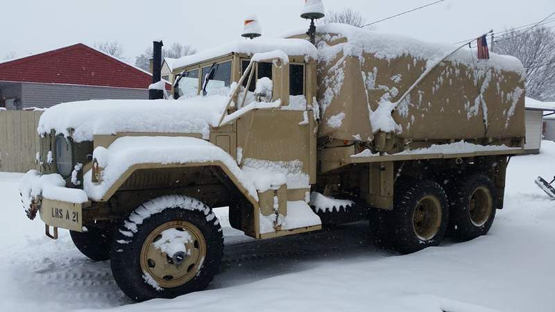

The last couple days we've had our first real snow of the season.
The pic was in the morning, with plenty coming throughout the day and that night. Went out, swept all the snow off, fired her up. The temps are still about 30 degrees, so I didn't plug it in. Started no problem. Went around and aired down all the tires to 20psi, rotated my locking hubs, and decided to load up with more stuff going to our storage shed on the south side of town. Tossed the kids in, and away we went. Soldier B and C had a blast. Everyone out shoveling would stop and watch us chug by. The boys would smile with HUGE smiles and wave. The thought it was cool everyone was staring at us. lol
AAR: She didn't let me down, not one bit.....again. The biggest thing I noticed with the front axle locked in for a whole day of driving.....man she sucks down the fuel!! lol Either way, there was no slipping. Turning was fine. Braking was fine. I'm on stock NDT's with not much weight in the back (I threw a few of my extra mounted NDT's in the back). I see all the time how NDT's are terrible. I haven't gone window deep in mud yet with it, but everything I have asked her to do so far she has done without falter. We also accepted an offer on our house yesterday so I'm thinking the truck sitting in the yard was the big selling point!!
