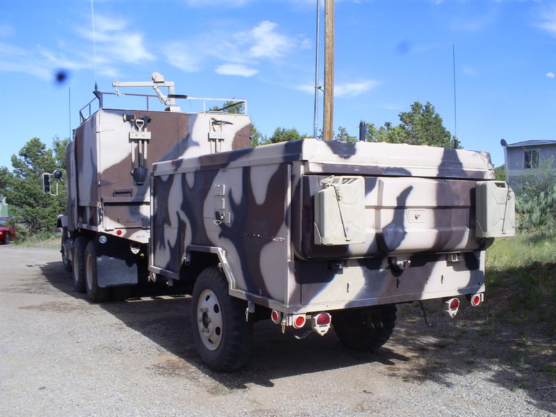

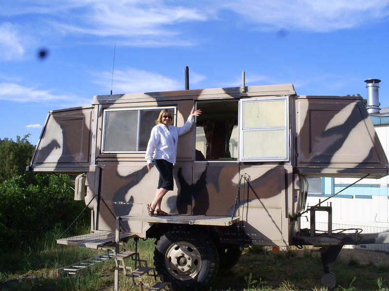

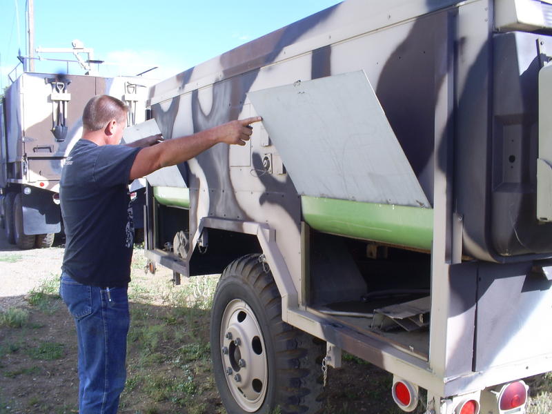

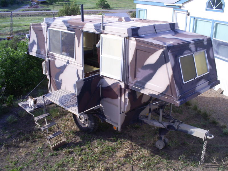

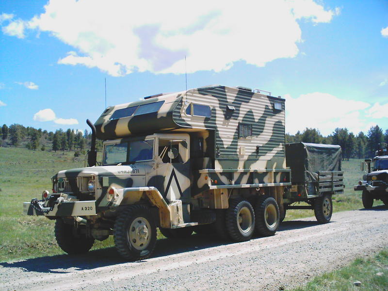

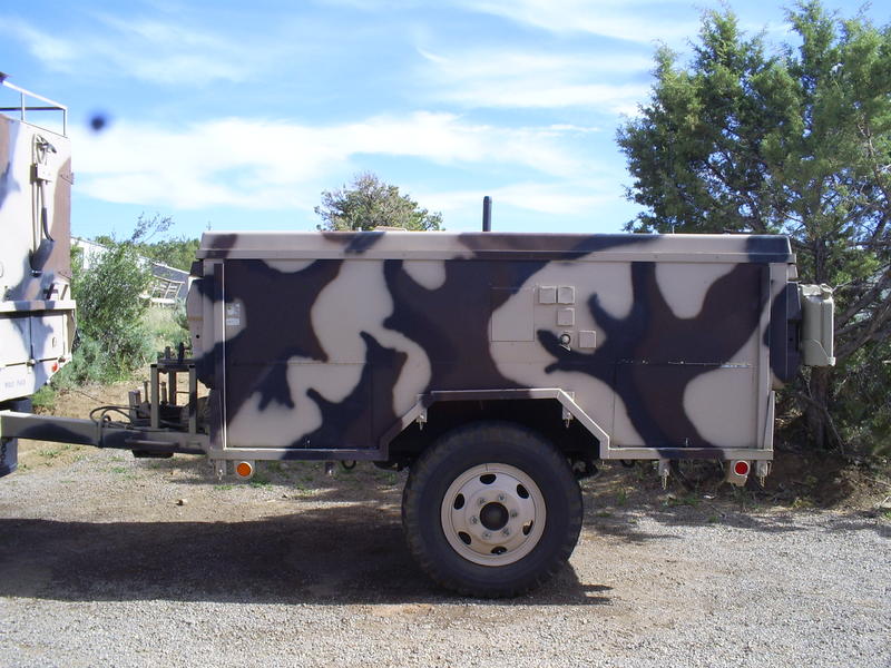

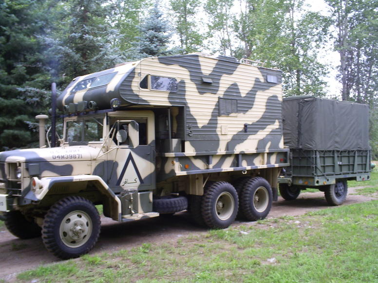

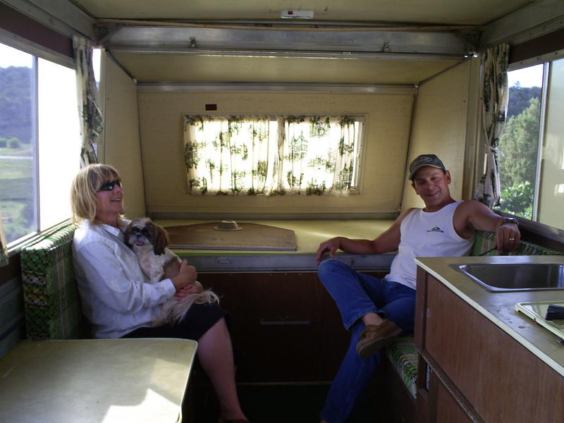

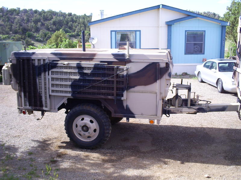

A friend on mine built this camper trailer from a military generator trailer to tow behind his Deuce. He has a sleeper mounted on the truck, and the rest of the truck holds all the gear. The generator trailer has a stand built up about 20" from the floor. He then took an Apache pop-up camp trailer and removed all the under gear from the unit and mounted the Apache on the stand of the generator trailer. The Apache has no canvas, but is an hard side fiberglass unit. Some tin work on the sides to cover a very large cargo area under the whole sleeper. Lots of little things done, but as you can see in the pics, it goes from a not to big cargo trailer, into a large water tight sleeping camper. I think it worked out really cool, what do do you think?

Wow...
Uncle Mikey. I have built some jazzy vehicles but that camp trailer made me feel all funny inside! THANK YOU for the thought provoking post. I am kicking around ideas for the ALCAN 2012 trip and this trailer would be great. Please contact me off line with a contact number of feel free to call 979 997 3112.

A friend on mine built this camper trailer from a military generator trailer to tow behind his Deuce. ------- I think it worked out really cool, what do do you think?
I agree 100%, really cool.
I would love to see a series of photos showing the deployment sequence of the stairs/platforms and the camper itself. Besides being very interesting it might help somebody with a part of their design.
Also, Mike, is the paint on your rig a specific camo pattern or did you come up with it? It is one of my favorite camo jobs I have seen and I really love your rig excellent execution.

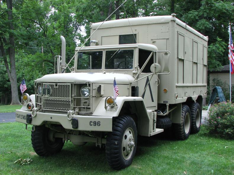

Lastly, and this is likely a dumb question, what is the inverted "V" marking on your door?
