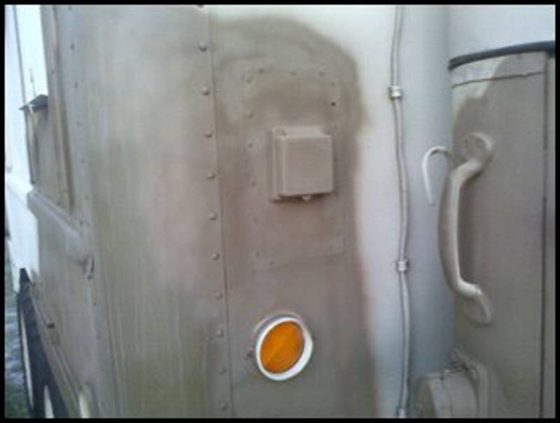

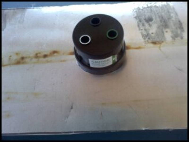

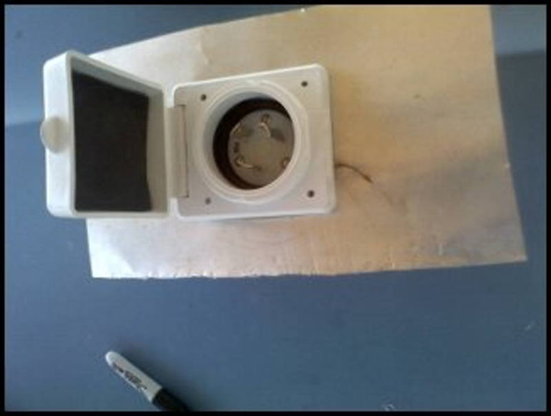

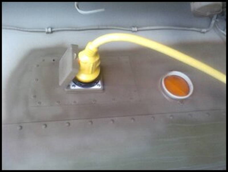

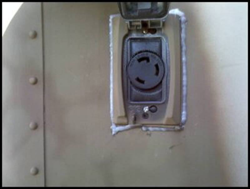

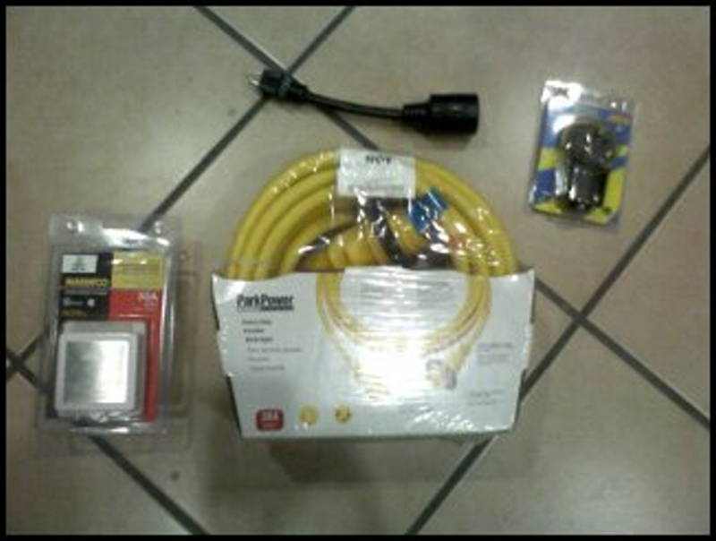

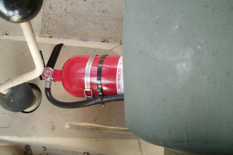

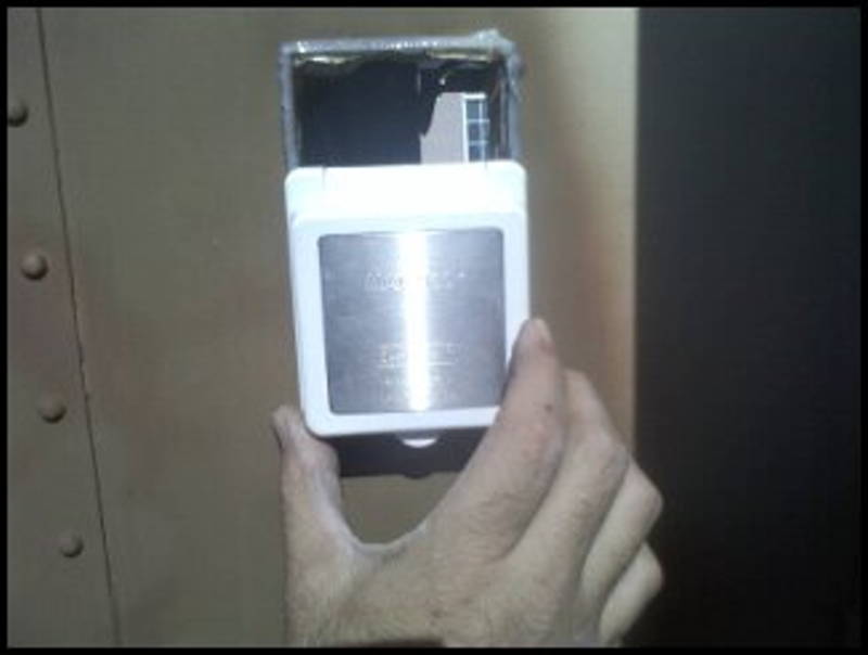

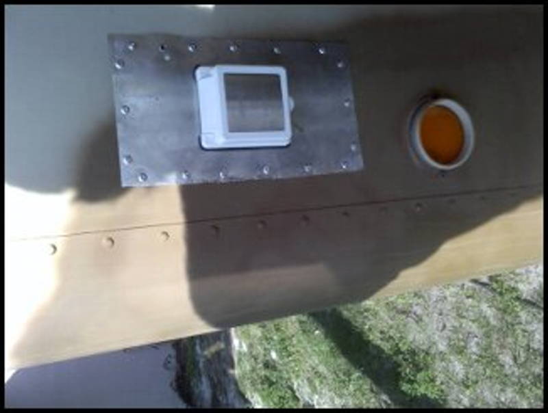

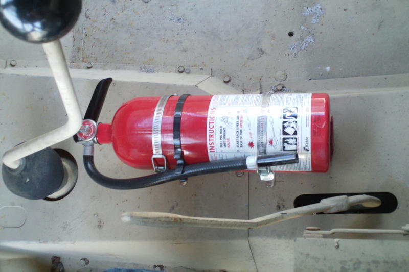

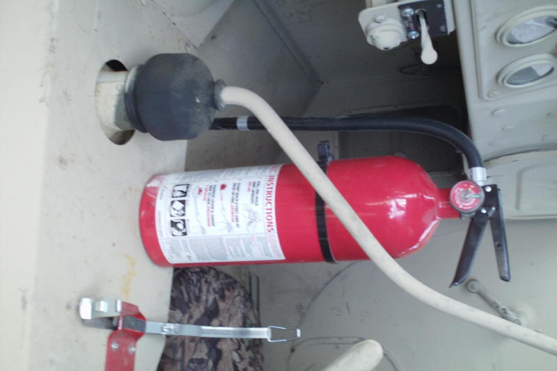

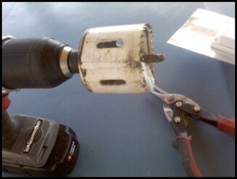

I HAVE POWER!!!!! This weekend i decided i need to change out the power plug i installed. PIC #1 As we look at pic #2 this is the stuff i bought. A 50ft power cord that is of marine grade. On the truck side it has a twist lock end so no one can trip and pull it out. On other side i shanged end t accomidate the RV hook up at campgrounds. jus in case they dont have either i can still plug into a wall socket. Total for the parts $231.00... PIC #3 is where i ran into a problem. New plug much smaller then previous one i had installed. PICS #4-6 are how i fixed problem... PIC #7 is of patch panel i made from a roll of flashing that ive been carring around for 6 years. PIC #8 is of installed plug and patch panel painted.. PIC#9 is of installed wire and PIC#10 LIGHTS ON!!!!!
