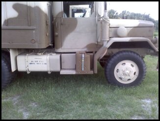

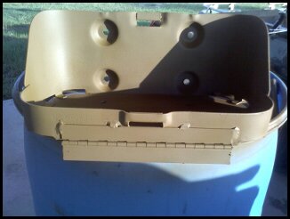

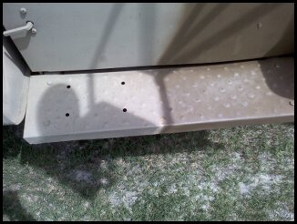

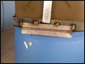

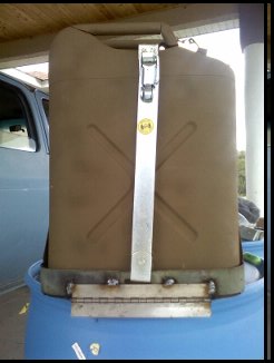

well i decided to make my own gas can mount for the passenger side. Ive looked hi and low for the real one like my buddy RAYZER has but no luck. Here are some pics of the stainless steel hinge i welded on. I was gonna clean the welds but no grinding wheels. This will be done this weekend finished and painted. Can anyone tell me why there r 4 holes in my step board. Im mounting can to the right of the holes

There is 4 holes because there isnt 3 holes or 5 holes, See thats why there is 4 holes. lol

I've always thought that there are 4 holes because it is the same part as on the driver's side where the holes would be forward.

can you do a close up of the mounts. i really need to get on it and put mine on...
all i did was weld a stainless steel hinge to the can mount then drilled 2 holes {jus for the record stainless steel dulls bits fast. I did 2 holes and barley made it through second hole} took some 1/4 x 20 bolts and lock nuts and bolted on. As far as holding mount down i went to Lowes and bought a specialty bolt that had holes in it and i used 2 fender washers and a cotter pin to secure it
