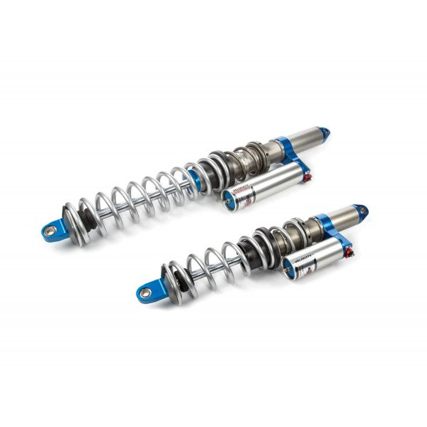

Front Shock Walker 7044788
Rear Shock Walker 7044790
$900 each from vendor, $600 each on Ebay

And they work like crap. See the top spring? See how it is compressed all the way? It aint supposed to be like that, but, from the factory, they are adjusted like that. Does your car have suspension on it now? If so, find a place by you that does off rod shocks, pull them off and have them re sprung and re valved. Day and night difference and it should only cost around &1500 to get it done. When you get them back, you'll see that the top spring isn't compressed, it can then do it's job.
Yeah, I see it. That's really weird. The for sale shock pic on the Walker site shows that top threaded ring only half way down the threads. The pic I posted shows that ring all the way down fully compressing the top spring. I'll call Walker and ask them about it. Hopefully there is some good reason why Polaris has that top spring fully compressed. It would be nice if we could clean the threads and just unscrew it back to half way. There are several weapons systems (like missiles, TOW, Stinger, etc.) being used in Europe. Get catch, and Thanks!!

It is like that because the things, in stock form, are enough to get t he car out the door. Don't buy new, they will be the same, just valve and spring them. My car went form harsh riding, bottoming over the smallest bumps to being able to cruise at 60 over 24 inch ruts.
The riding in your neck o the woods is much different than out my way, but, the suspension mods were the best thing I ever did.
Get those measurements and I'll compare to my stuff. I will almost guarantee that the joints on the radius rods are shot and, if it has been ridden hard, the lower A arms are either bent or cracked. If they are the same, IMHO, the stuff from Super ATV are great quality. Get the high clearance lower radius rods and A-Arms if your stuff is damaged/worn out. Make sure you service the final drive and the on demand front end. Lack of love on those items make their lifespan short.
