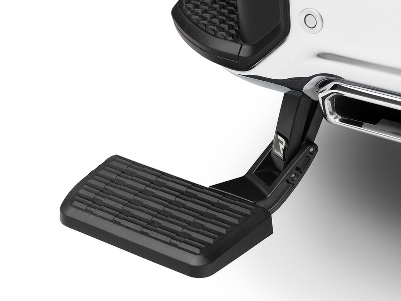

I like the idea of an automated step that comes down when the door opens. But at the end of the day, it becomes another moving part to break off-roading. I guess it'd viability/longevity would be based on truck use.
From an engineering standpoint, I'd likely just have a flat step that sits flush up against the base of the box. When the door is opened, the step lowers to the level of the OEM step.
There are some interesting solutions that might open themselves to moding:
or like this (bonus points for being "stripper friendly")
Then there are the manually folding step options (my biggest issue here is "how to deploy them from a sitting position inside the cab"):
You might also look to "bed steps":
Cheapest solution is to simply replace the cable. Some neat alternative ideas out there, though...
