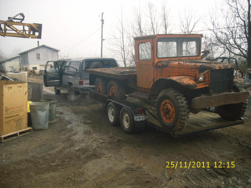

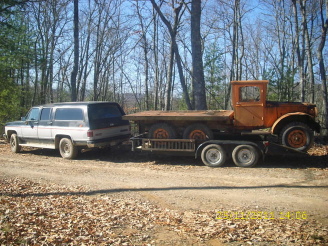

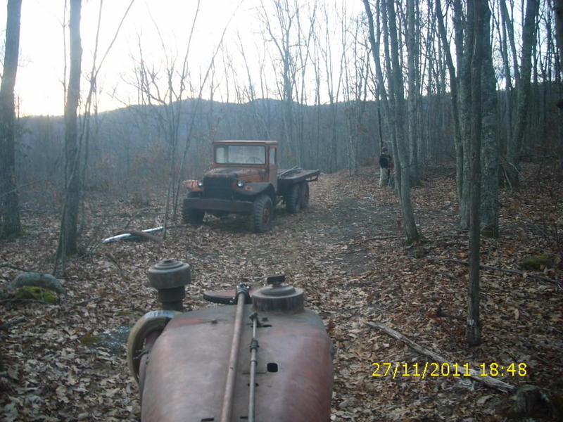

Hauled it home (around 50 miles) on Friday, without incident, after a little uncertainty about whether it would fit on the (borrowed) trailer, and whether trailer tires were really flat or it was just heavy. . It weighs 7040 lb, which made it a lot more expensive than I expected. Included a 7th "combat" wheel.
Suburban pulled it up 19% grade at the beginning of my road in 4WD Low. (15,000 gross)

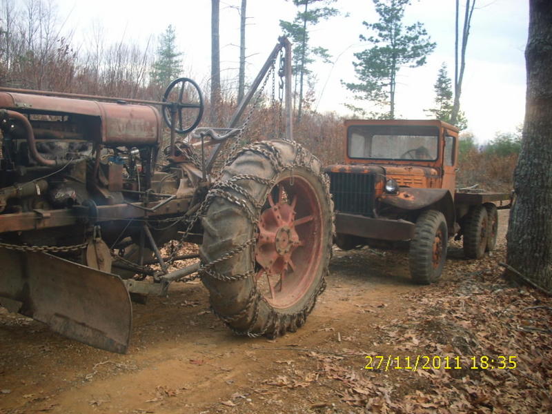

1931 Farmall regular towed it the rest of the way up my mile driveway. Al l tires hold air, all the wheels turn, transmission goes in gear and back to neutral...Thass all I know so far.
I like it, but I'm already in deeper than I can afford.

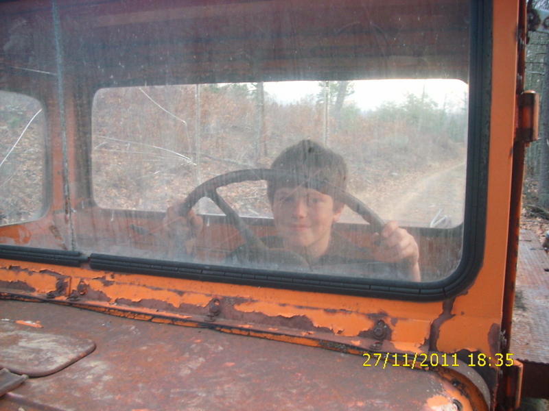

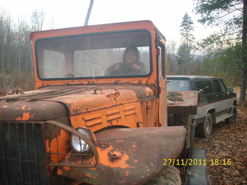

I would guess that because of the hard top, the trans would be good, no water
who ever that is in the cab in pic #3 sure looks like thay are having fun

My WC51 was painted the same color and had an identical hard cab grafted onto it's original open cab which certainly saved it from the elements. My truck was a European return brought "home" some time in the 1970s. Think it was imported by Seaco from Switzerland.
About those cabs. When I first got my weapons carrier, I was talking with a fellow who knew far more about Dodges then I. When I described the hard cab to him, he thought that it was something that was done in the later 50s. My opinion, is that they were either added by the Europeans (like the Swiss) or it was a commercial aftermarket item. Either way, it's a factory (not home made) item.

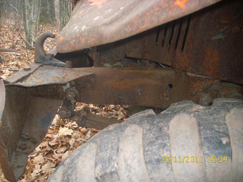

Now that looks like a great start. The frame appears to have been well protected. Enjoy and remember, you've got lots of help in here.
Have you found the VIN# yet? then you can know the production year. [thumbzup]

Yes, I believe the aftermarket cab.. There is a plate inside it saying something like, "Chicago Manufacturing co"..I took more photos, but no time to upload them now.
I found serial number(s?) on frame forward of left front wheel. On top of frame rail, "6668". On outside of frame rail, directly under the former number, "82026998" There is no information plate that I could find inside the cab or on dashboard.

Is there a particular part of this forum where I should post the numbers I have found on the truck, on top of left frame rail in front of left front wheel "6668". On outside of frame rail, directly under the former number, "82026998"

Is there a particular part of this forum where I should post the numbers I have found on the truck, on top of left frame rail in front of left front wheel "6668". On outside of frame rail, directly under the former number, "82026998" I'm not sure what the top four digit number denotes but, the bottom one is your truck's serial (Vin) number. I think I may be able to look that number up and tell you what contract that came from but i have to find that particular book in my library first.

What I suppose I would need to do to make this a marginally practical vehicle for me is to cut the back off the cab and add (at least) another row of seats, and either lengthen the frame or shorten the 10ft bed. The grinning driver of photo 3 above is my 11-year-old daughter, number 3 of 7.

If/when you remove that hard cab the rear wall will no longer be a problem. But you will then need a windshiled frame (inner & outter)& mounting hardware. The bed on there as you can imagine is not OEM for the WC63. What I should have mentioned with my WC, is that during the course of it's restoration, I removed that hard cab. With it off, you'll probably find sitting in that truck not quite as clausterphobic.

Using your Dodge Serial number 82026998 it decodes this way from this site
http://www.t137.com/registry/help/decode.php
Serial Number,82026998 Year1943-45 MakeDodge ModelWC-62,WC-63 TypeMilitary - 6x6 Engine230 Flathead Six Wheelbase125 Rating1 1/2 Ton Engineering CodeT223 PlantDetroit, Michigan Build Number 26998

That build number should be an early to middle 1944 production date, I forgot to check my books today at work. All the info you need for this truck is available, I have the reproduction pubs (Portrayal Press) and the same on the computer from a cd.
