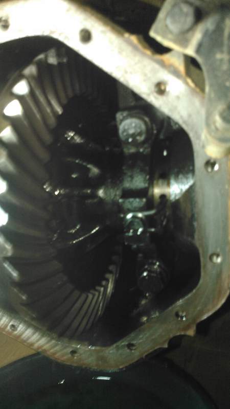

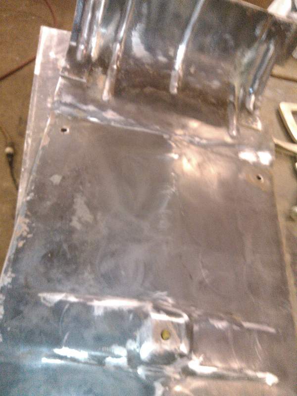

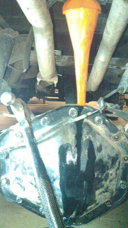

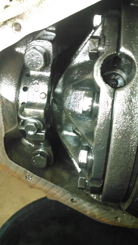

I finally got around to changing the oil in the rear differential and checking out the chunk. I got the truck in my dad's shop on concrete and started working. I had my new gasket, my oil, permetex and tools. I cleaned up around the cover before I started pulling the bolts. I tool the bottom bolts out and started my way up and that drained the oil. Once I had most of the oil out I took the cover off and started cleaning out the housing.
Then I cleaned up the cover. I used a knife to scrap the housing and a side grinder and a worn out flap disk to clean the old gasket and such off the cover.
Then I started putting it all back together. I put permetex on the cover, then stuck the bolts through it, then the gasket, then I put permetex on that, then bolted the cover on.
Then I started to fill the oil and had a issue. The oil fill plug was broken off. So I ended up loosening up some of the cover bolts and stuck my plastic funnel in the top and started tightening bolts and pouring in the oil. I filled the oil and all was good.
Thank you all.

I had a '99 C3500 where the diff plugs were rusted solid. I was afraid to remove them, because even if I did manage to get them out, I feared it would do enough damage in the process that I wouldn't get them to seal well again. Looking at them, I imagined the heads would shear off before the bolts would turn. Perhaps the hot torch/cold water treatment would have worked, but brake lines and fuel tanks were close enough to make me reluctant.
So I parked it on a side slope so one wheel was higher than the diff. I opened up the uphill hub, and poured the right amount of diff lube down the axle. I changed the wheel bearings while I was in there. Worked great for me.
jpg
611
15
Boston, MA
Thanks for the tip. I figured next time I pull the cover a aftermarket machined cover with a fill and drain will go on.
That would work. You've inspired me to go check my plugs for corrosion, and make sure they're well protected for the winter. I'm trying to keep this truck from rusting, to the extent possible.

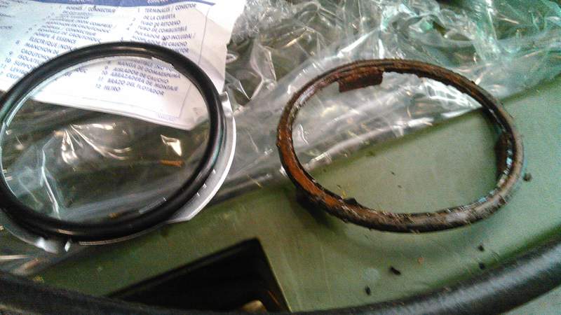

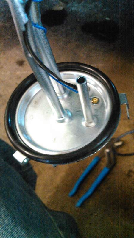

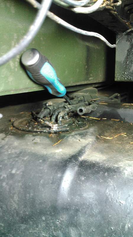

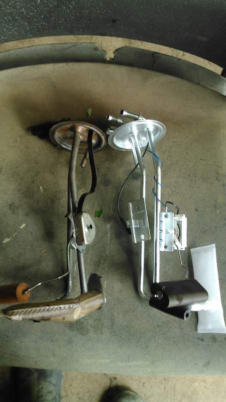

My truck had been running great for no problems for awhile but my good luck ran out. My truck is usually parked nose down, well one day it sat all day nose up at a decent tilt. Well I hopped in and it fired right up, I put it in reverse and it went dead. So when it did I just popped it into neutral and rolled down the hill to the flat ground and it cranked over for a little bit then started up and off I went. So the next day it did it again, this time the batts died before I got it going. So I pulled it across the street into my dad's shop lot and charged up the batts and in the lot it was level and it started right up after a little cranking.

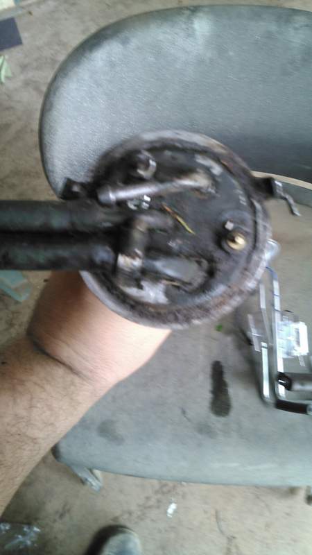

So I thought maybe my fuel pick up tube was rotted off since it only started when level. So I got a new sending unit from Canada and installed it. The old hoses had to be cut off the steel lines to remove them so it was time to change them anyway. I am so glad I have a flatbed or this job would have sucked.
The old sock was kind of dirty but not completely stopped up. I looked in the tank best I could and it didn't look bad. It did bother me when I pulled the old unit and the pick up was intact but I figured it was stopped up just enough for it to sometimes clog the flow of fuel.
Also I did pick up on power since the fuel flow was better and My gauge works better now.
Thank you all for looking

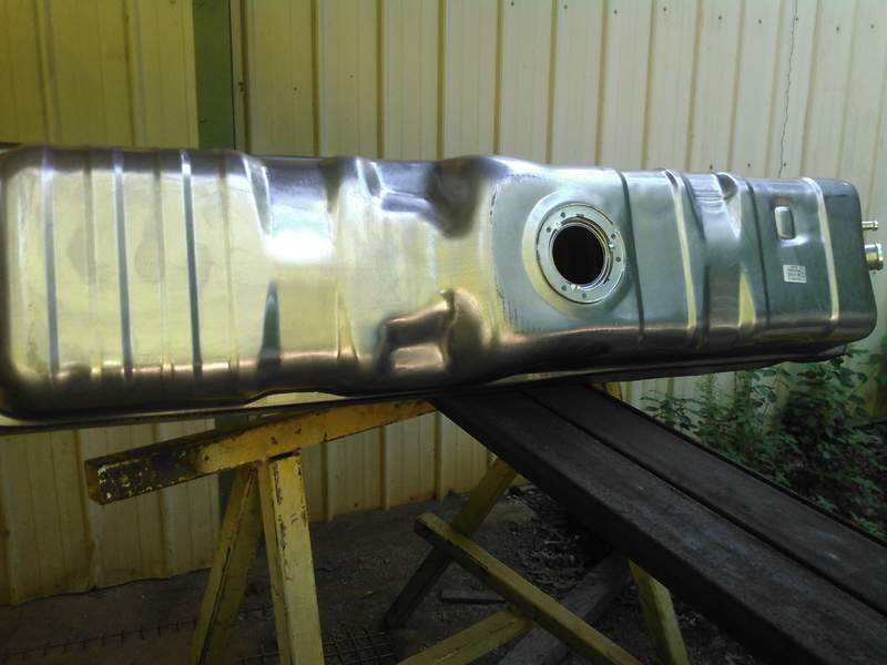

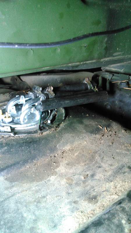

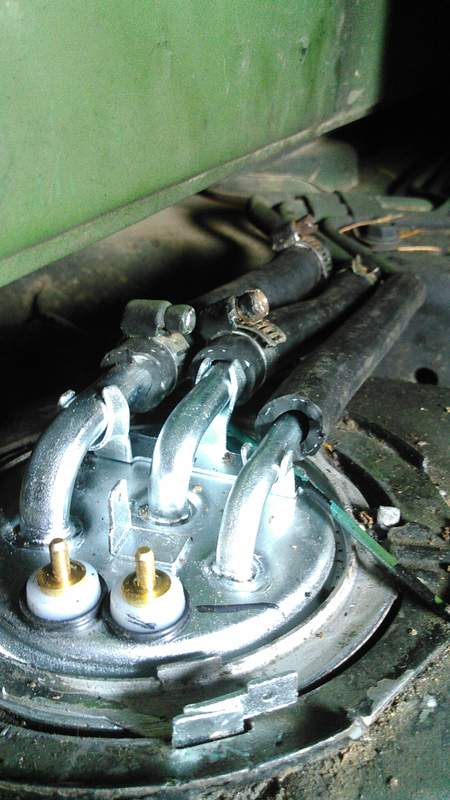

I pulled line coming from the tank and blowed compressed air back into the tank until I head bubbles. I hooked everything back up and the truck fired right up.

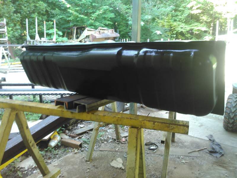

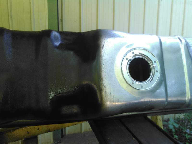

So I decided to order a new fuel tank. I got it from Napa it is a welded steel tank, instead of a plastic piece of junk like most places sell.
So my new tank came in and I started prepping the tank. It had a coating of oil on it to keep it from rusting. I wiped it down with lots of paint thinner and cleaned it up. Then I sprayed it with about 3 coats of rustolum rubberized undercoating.
This will keep it from rusting, help protect it and make it look better. Then came the job of swapping out the tank.

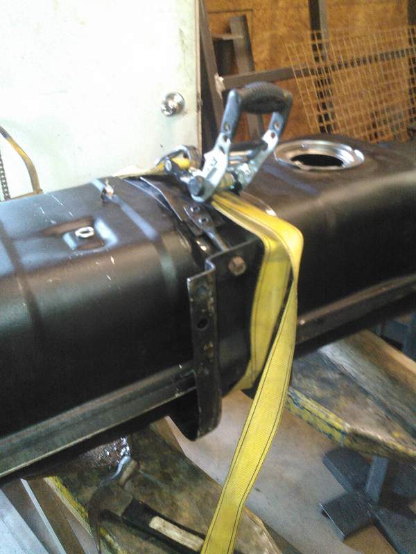

I unhooked the fuel lines and wires, then I put a small lift under the tank and took out the bolts that hold the straps to the frame. Then I started taking the straps off the tank. I had been using lots of wd40 and PB blaster but I still had one strap fight me. The nut that lightens the strap on one of the straps would not come off. So I drained all the fuel from the tank, which had lots of junk in it. Then dad heated up the one nut until it was red and I was able to take it off. Then we ran a thread die on each of the strap studs to clean them up.
Then I cleaned all the rust off the straps and the where they bolt to the frame and sprayed them with rubberized undercoating.
I also cleaned up and painted the skid plate for the tank
Once everything dried I started to re assemble it. I had to put the straps around the tank then use a rachet strap to to get the studs in the holes then tightened them with a impact gun.
I also put rubber around the tank where the straps go. I used strip door material.
Once I had it it put together I got the tank under the truck then started hooking everything back up. The new tank was a great fit and I have had no problems with it.
I did have a problem with my filter sock. The one that came with the unit was trashed so I needed a new one. I looked around and I came up empty all I could get was one for a gas tank with a intank pump. So I got that and cut it apart and used just the outer screen and a hose clamp to keep it on the shaft.

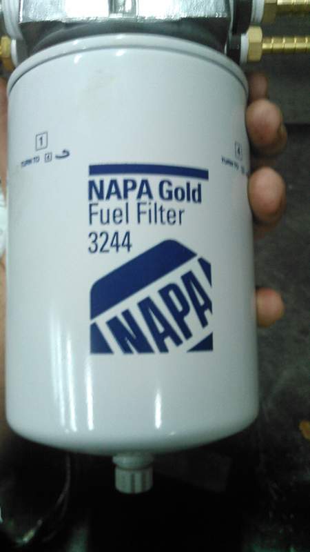

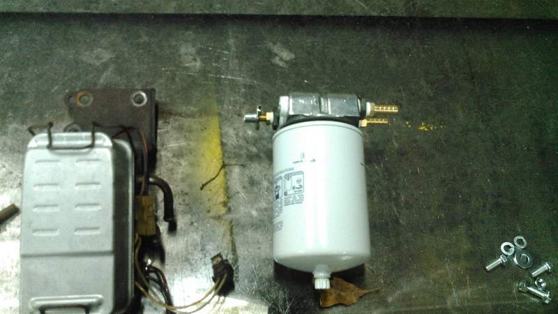

At about 2700 rpm in high gear it would start popping, stumbling and making a racket. So I finally found out that filter base can leak. (I should have searched sooner.) The truck would lose prime in a matter of hrs. I was trying to get the truck started one day and I had fuel at the filter and I could get a little drip at a injector line. So I ended up pouring about 16 oz of fuel down the intake. It smoked like a tire plant on fire but the truck started and didn't try to run away.
So finally I heard about the filter bases leaking. So I bought a small clear inline filter for and put that one inplace of the stock unit. All my troubles when away.

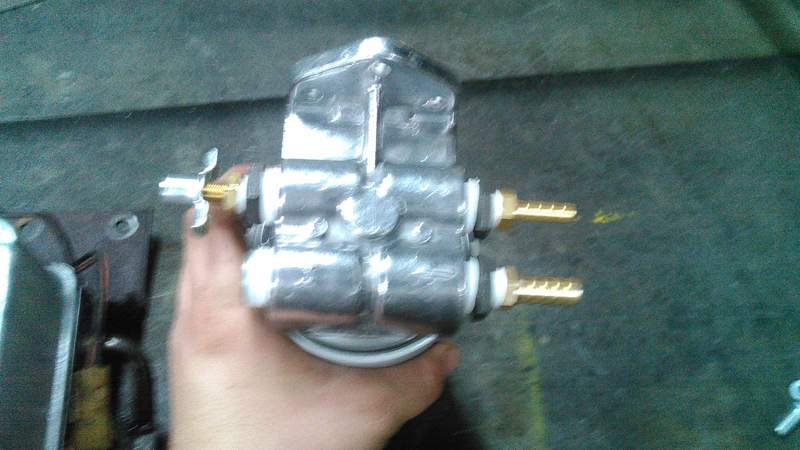

So I started getting the parts together for a spin on fuel filter. I got a wixs filter head and filter. The head has 2 in's and 2out's, and the filter has a water separator with a drain in the bottom. I had to make my own bracket to mount the filter because with the stock bracket the filter hit the engine. So a quick fab job and I was good to go. I just welded two pieces of 2 in angle together for a nice clean mount.
Then I plugged one IN hole and used the other, the I put a small valve on one of the outs to drain the air.KIMG0846.jpgKIMG0848.jpgKIMG0850.jpg
To reprime the system I used a primper bulb I put in the fuel line where it leaves the tank. All I had to do was open the air bleeder valve and squeeze the bulb until fuel ran out.
That way I didn't have to work my starter to hard
I will post the part number for the filter head if I can find it.
This filter has solved all my issues and now my truck runs so much better. The truck runs as good if not better than it probably did when it was new.

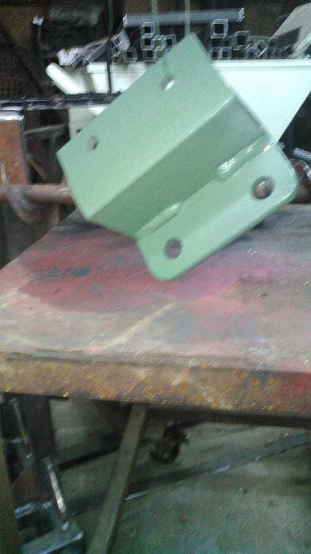

Lift shackles
Hello all its time for another installment.

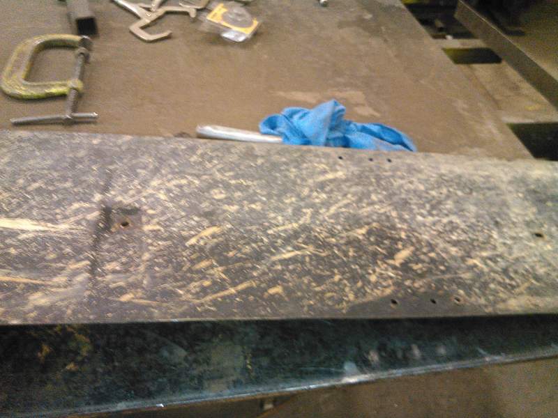

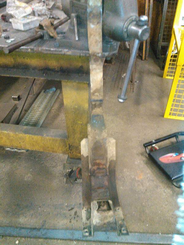

The truck did not have any shackles on it when I got it. The front mounts where still in the truck but the rear mounts where removed when the flat bed was installed.
So I had looked on eBay and take off shackels or nos ones where expensive for what I could get. So my dad does a lot of business with G&H industrial supply in Jackson. So he carries big shackles and other stuff. I found some shackles he had that where screw type, made in America, and 8.5 ton rated. The cost about $75.00 a piece. At the time eBay shackles cost much more.
So I pulled the tubes off the truck to drill out the holes a little because the pins didn't fit. I got the holes drilled out then I painted the tubes black, after I cleaned them up a little.
I used all new washers and lock nuts. I would have replaced the bolts but I didn't have any. I didn't. Weld the pins but I did tighten them extremely tight with a large cresent wrench.
