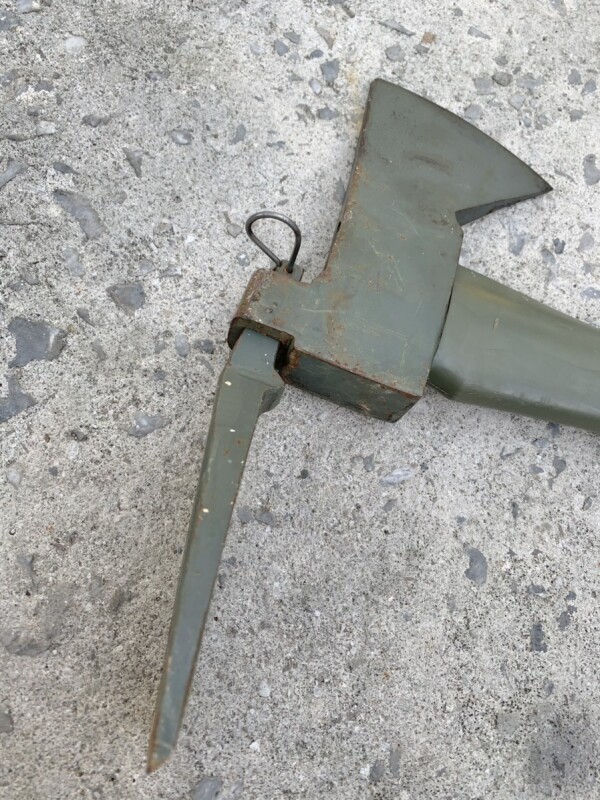

Pulled all the chairs out and lifted or removed the matting- all San Yermo mud under there. I started with a putty knife and scraped the mud up, then mowed the front yard. That brief break dried the little bit of mud left, so I vacuumed up as much as I could, then got the hose and a scrub brush to finish it.
I'll need to vacuum again to get the little bit of sand that didn't run out the drains tomorrow when it dries again.
Found this, no idea what it is.
