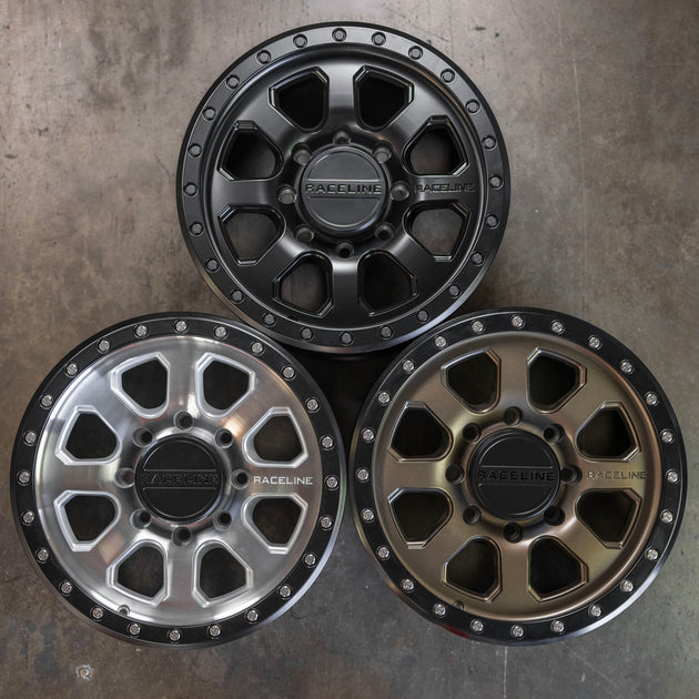

thoner7
398
237
NE TN
Figured I’d share these, they are 17x9, and have a +20 offset which is one of the largest I’ve seen. H2 wheels are 17x8.5 are +18. I only mention that because they keep the whole tire inside the fender.
They don’t mention a weight rating but if they work on a big dodge 3500…
I hope I’m not missing something with these, chime in if I am
